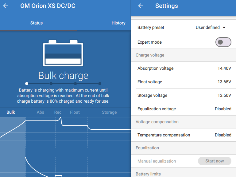

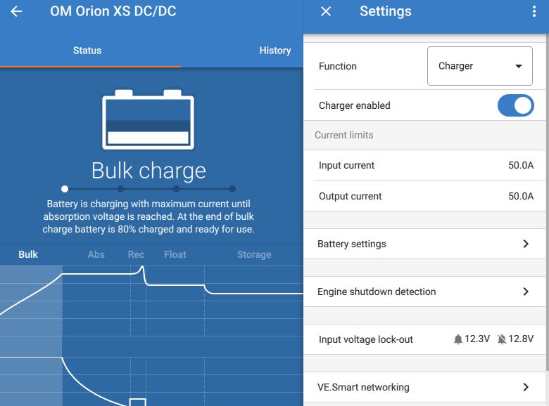

I have attached a couple of settings screen shots in case that is helpful.

Check the setting for “Engine Shutdown Detection”
It should be on automatic so that Orion XS sleep when engine is not running and activate only with running engines.
The Orion XS uses only a few millivolts when sleeping so with good batteries it should take a long time to see a voltage drop. There is also more information and explicit warning regarding this matter in the Orion XS Manual.
Yes, Input voltage lock-out should put Orion XS in sleep mode, but maybe your solar panels avoid that as voltage is higher but amps lower than actual power draw from your electronics.

Thanks Chris. But we also have our shore power charger configured through the DC/DC charger, so I’m not sure this setting would apply.
Can you explain that better?
Engine shutdown detection works either by sensing higher voltage or by alternator running signal from alternator. I believe that it does not matter if higher voltage comes from alternator, solar or shore power charger.
Can you make a diagram what is installed and how it’s connected?
Chris
Correct, the source of the voltage rise on the input side does not matter, can be a running engine/alternator or some other power source.
Do you have engine shutdown detection enabled and setup correctly? What does the Orion say while its draining the starter battery, is it measuring a high enough voltage?
