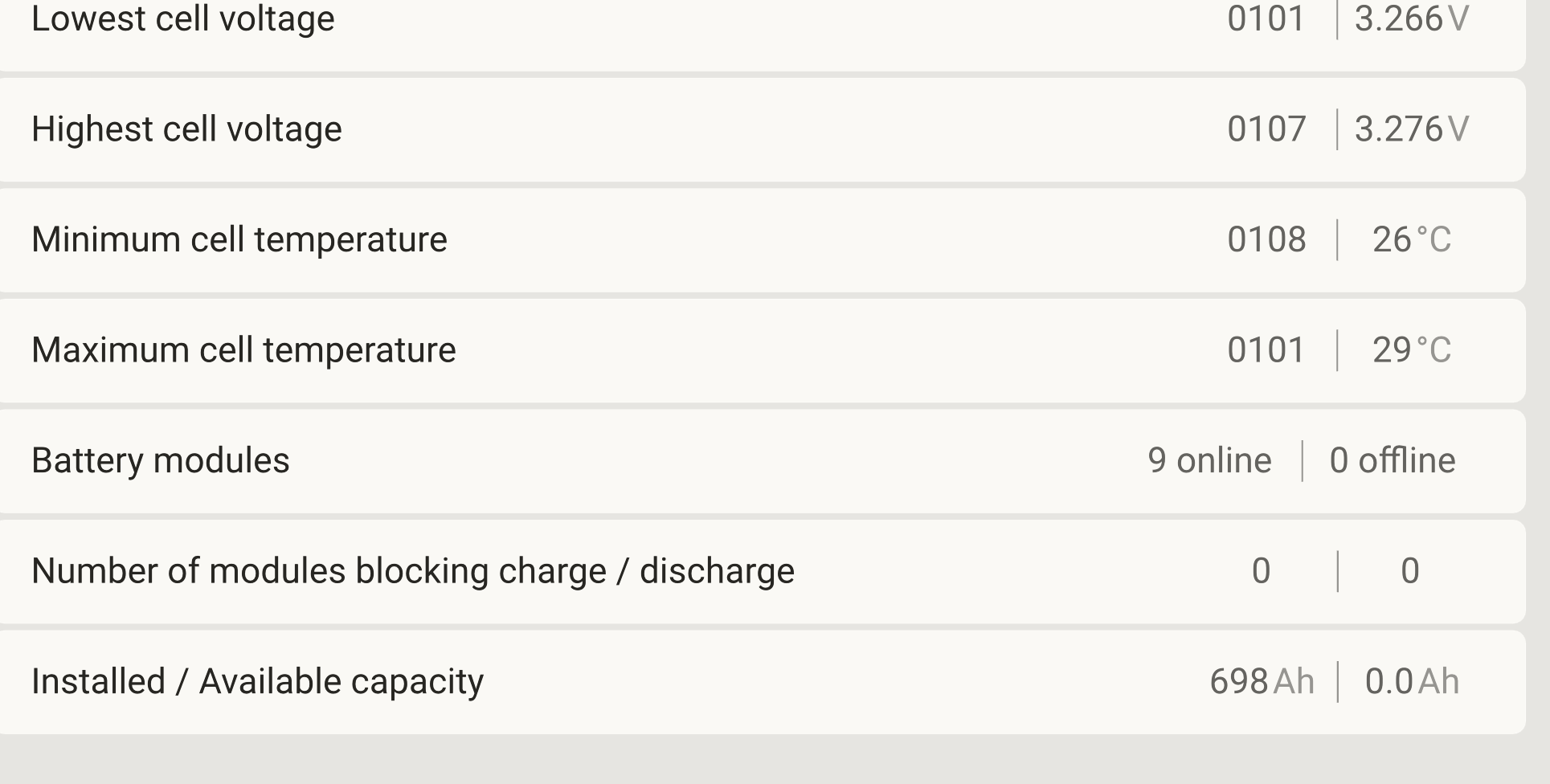

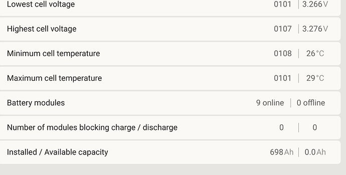

Thanks. i have 9 x US5000C and they say they 100ah so i put the setting to 900ah?
Sounds right
