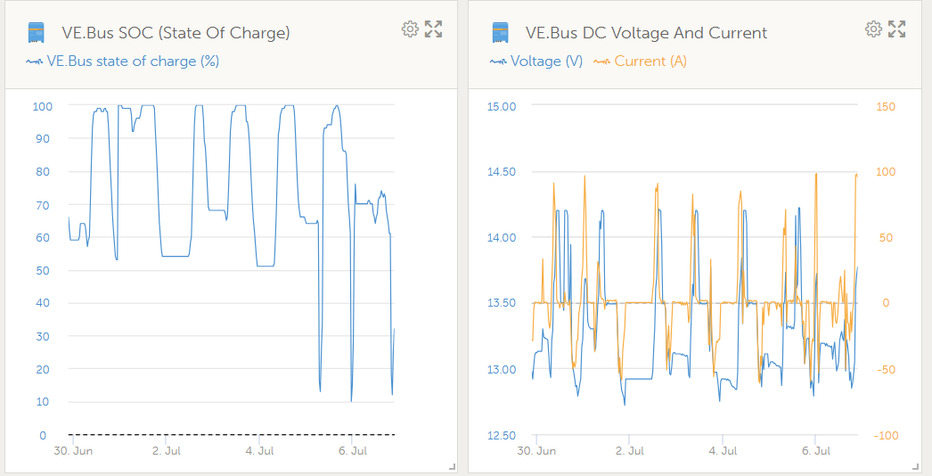

See the attached Graph of SOC and DC current and voltage.

For better understanding you have to examine how the battery voltage and current behaves when the SOC passes from 60 to 10%. It could be that your battery has a problem (wear ?). Examine if the DC connections between batteries and inverter warm up more than before.
As @molenman says you need to look at the data for the few hours where this happens not for a week, it is too coarse to see the detail, plot a 6 hour data window or finer. The Multiplus SOC is calculated from current in and out so you need to confirm what was flowing out during that time. It could be DESS pushing a discharge.

attached is a more detailed output of current and SOC for one of the events.
The doesn’t seem to be anything out of the ordinary happening on a voltage and ampage but your veiw would be appreciated.

Looking at that chart, at 07:00 for some reason the SOC dropped from 60 to 0% so the batteries started charging. After just under an hour of charging at 100A the batteries reached absorption voltage of 14.2V, so end of bulk, so the Multiplus SOC jumped to 95%. I assume you have the battery monitor set to go to 95% at end of bulk. So the amp hours recharged agrees with the 60% SOC.
The drop to 0% SOC was nothing to do with discharge.
What I can not answer is why this happened. Some of the Victron battery monitors reset to 0% if they loose input voltage so the battery monitor function in the Multiplus could have developed a fault pr it could be a genuine loss of voltage.
