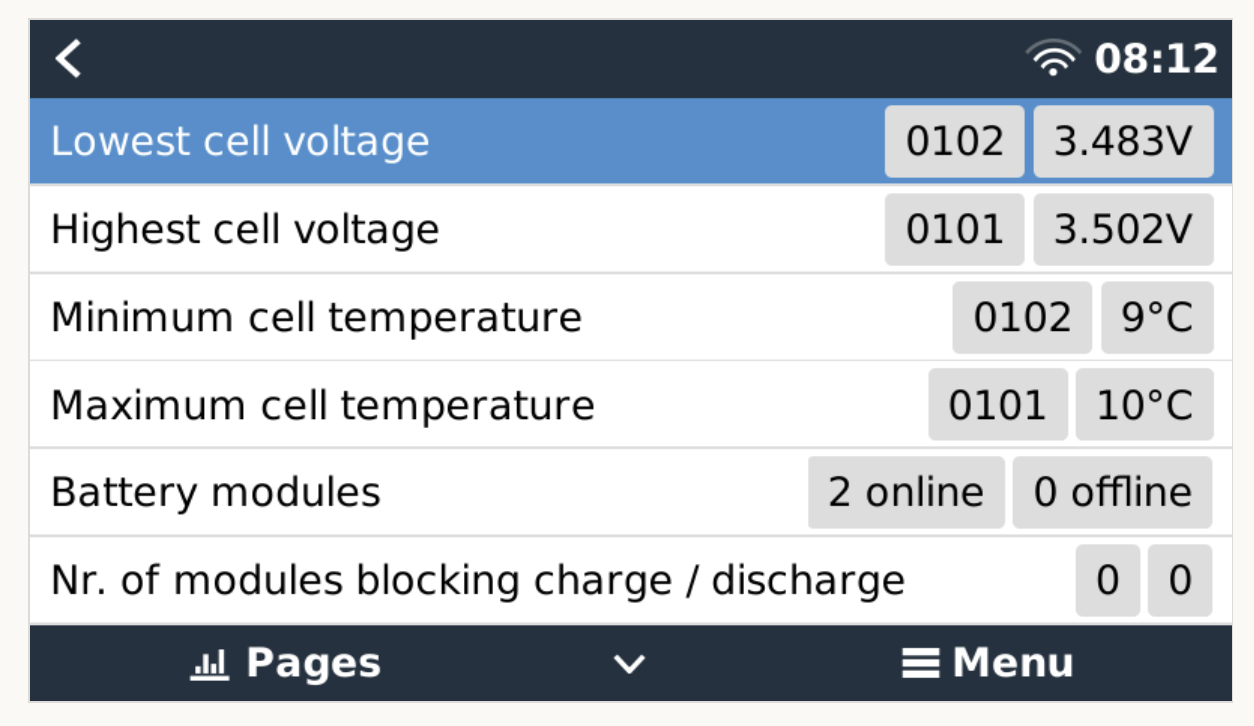

As to cell balance, this is what I see:

That seems a perfectly balanced group at 100% SOC… :slight_smile:

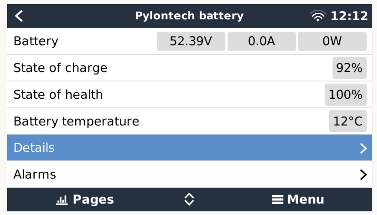

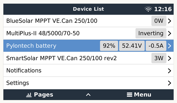

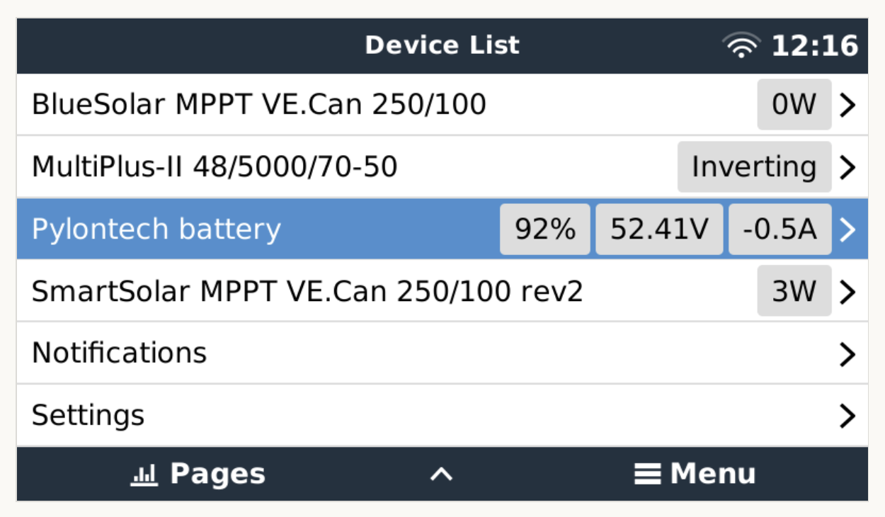

Also, if the above figures are for a below 100% SOC, then which are the followings, in the exact same moments:
  • battery current
  • battery CCL
Both found on Pylontech menu, first on the first line of that menu, together with voltage and power, the second on the Parameters submenu.
If the CCL is different than 0 then one or both of the batteries are still charging/balancing.
Also, I’ve seen cases when CCL is 0 and the battery is still balancing and in that case the battery’s current to be something like 0.1A or a little bigger.

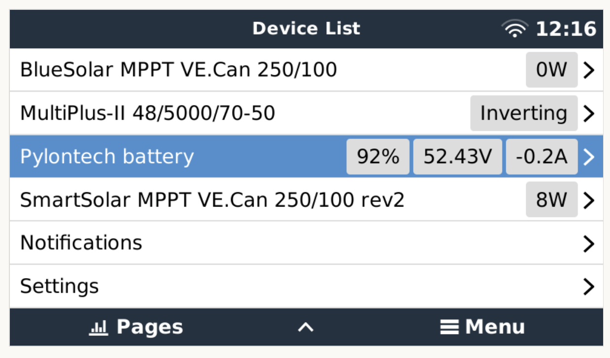

I will check the values this evening when the situations repeats.

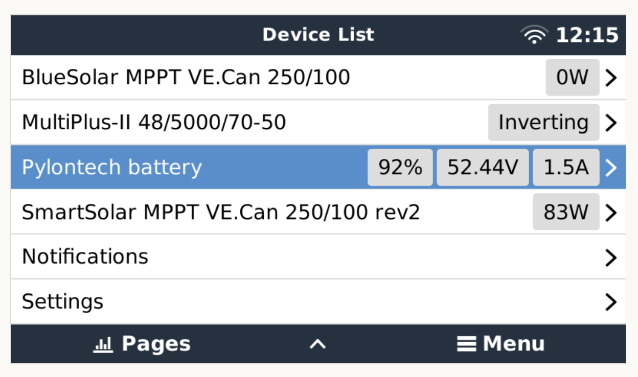

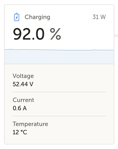

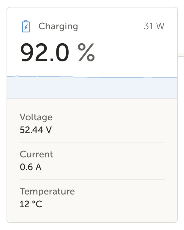

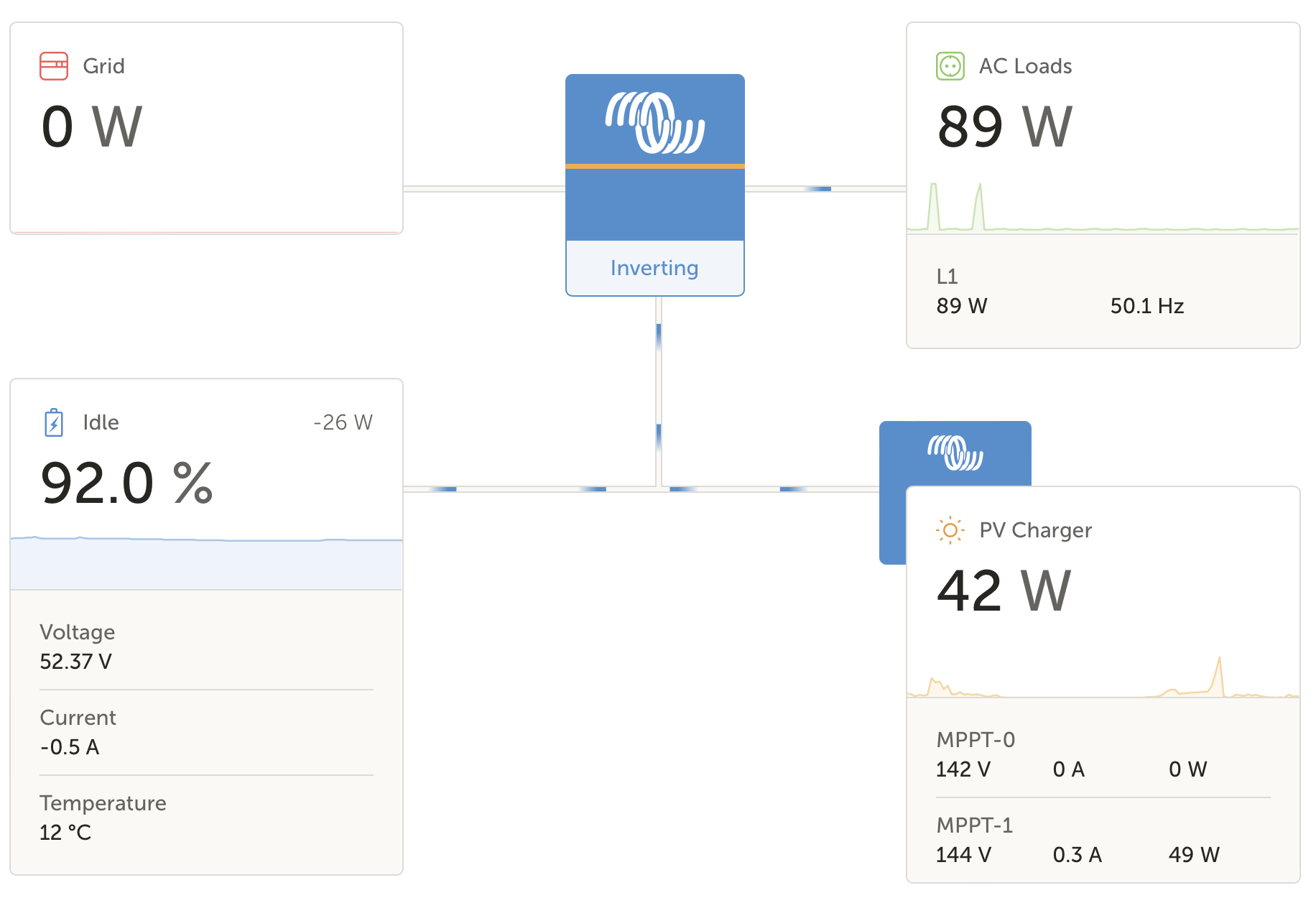

Here is sample of the values I see. The charge/discharge current fluctuates between charging, not charging, discharging at some 10-15 second interval with no apparent pattern.

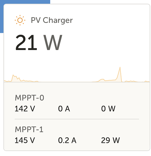

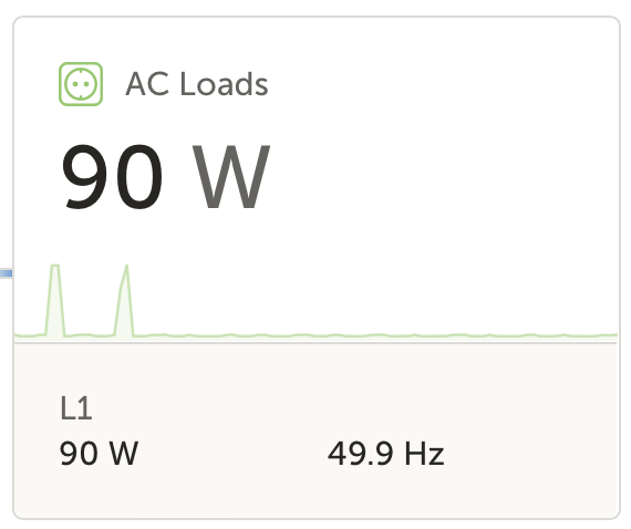

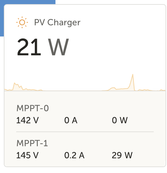

From the first (over vied picture) you can see the two consumption spikes (AC Loads) last night when SOC was 98% (or over) twice and from the PV Charger plot you see how the over night consumption was quickly replenished some hours ago and now the SOC has been stuck at 92% for some time.
