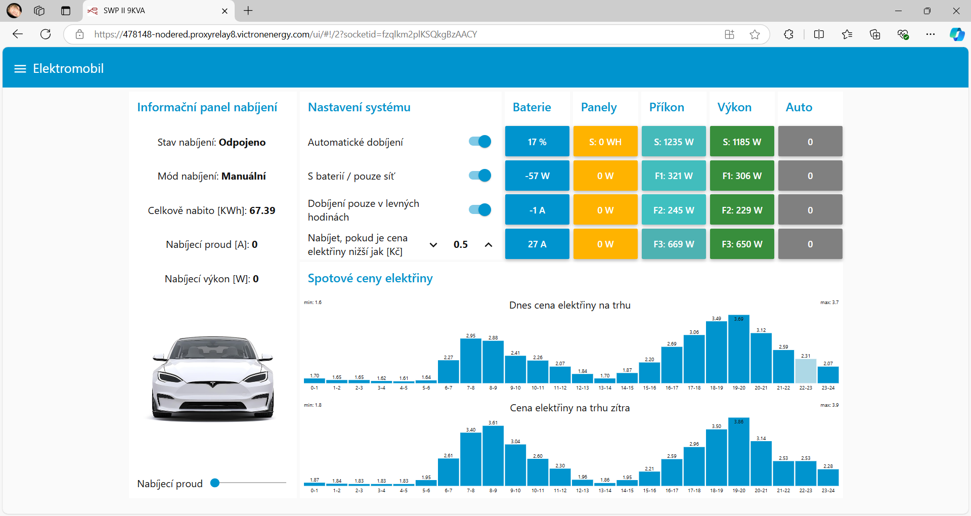

Automatic Control of Electric Car Charging
The system automatically manages electric car charging based on the current load of the house, to prevent overloading the main circuit breaker. The charging current is dynamically adjusted to maintain stable household operation. Moreover, the car only charges during cheap-rate periods, which significantly reduces operating costs.

Battery Charging and Discharging Based on Electricity Prices
The system also manages the battery to charge during cheaper periods and discharge when electricity is more expensive, to meet the household’s needs. In this way, I aim to take full advantage of electricity price fluctuations on the market and manage energy as efficiently as possible.

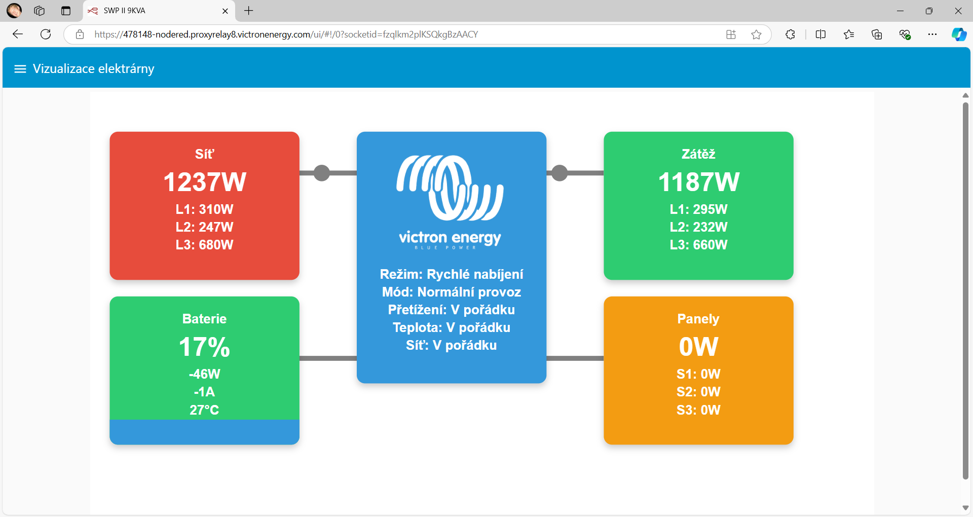

Below, I have attached some screenshots of my system’s visualization, showing, for example, the current power distribution, battery status, electric car charging control, and usage during cheaper hours.
