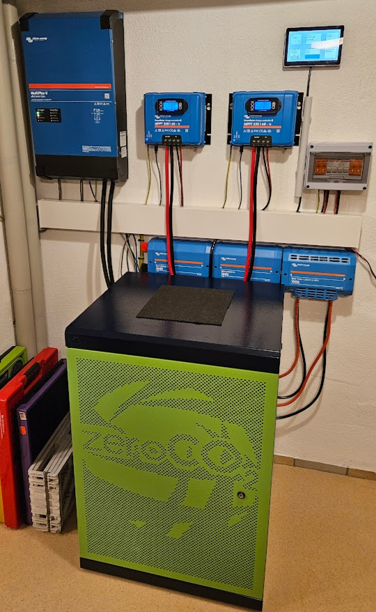

My system – DC-coupled DESS 4,5 kWp - 9,6 kWh
  • I have a mid-terraced house with a dormer window, southbound -10°
  • Slope 35° and 20°, PVGIS yearly forecast is 5035 kWh
  • PV Modules from MAXEON, SunPower Performance 7, 450W
  • At the moment, no hourly energy price contract
  • Tibber and SmartMeter Gateway expected for May 2025
  • SinglePhase MultiPlus II 5000 48V, Grid Code DE, 4,39 kWp
  • Multi-Phase Compensation
  • Critical loads on AC out 1 (Blackout) of the Inverter
  • Heavy loads (Wallbox, Washing Machine, Dryer, Oven) in parallel on grid
  • Two MPPT 250/60
  • Cerbo GX with Touch 70, Venus OS 3.51
  • Two PylonTech BMS US5000 LiFePo4 Batteries, stored in a 19’’ cabinet
  • Two Lynx Power-In with Distributor Mod
  • GridMeter EM540
Installation
I read the Victron manuals twice upfront, minimum. ESS, product manuals, PylonTech BMS setup, … That helped and the installation was kind of straight forward. Nevertheless, I was surprised about how many different tools, interfaces and protocols are involved until everything is setup: VE Configure 3 for the Inverter, VE.bus interface, VE.direct interface since one Smart MPPT BT connection could not get to work properly and the GridMeter configuration tool. As soon as everything was connected to the Cerbo, firmware updates are easy to deploy via VRM.
The Cerbo GX concept is great. It starts automatically recognizing the connected devices. Configuration is not complicated. DVCC gets enabled or even enforced automatically after the BMS battery detection. Just the MP II needs extra care and extra configuration with the VE Configure Tool. You need to be careful and precise here with correct settings for grid code, currents, assistants and battery parameters. That takes some time and needs focus.
VRM does a great job. ESS as well. Regarding DESS, it’s not always obvious why it takes the one or other decision. A kind of verbose information about the current mode and reason why that mode makes sense might be helpful. DESS is a promising concept, and I am confident it gets mature and better over time.
Trade is not an option in Germany, so I go for green mode at the moment.
What I really did not expect, how noisy a MultiPlus can get in regards of humming and fan noise. My installation is in the basement with a closed door, and I still could hear it in the house. Just the humming already. At the end, I decided to take own measures to get the unit more silent, knowing that it might lead to potential warranty denial. Would love to have a “quiet product option” on Victron side. I even would buy another silent Victron inverter in case that gets available someday.
All in all, I would buy all the components again. The PV modules seem to do a good job, even in cloudy conditions, the Victron products work nicely and have a great quality appearance. The batteries as well and they fit very well into the Victron Ecosystem.

Setup was closely aligned with a professional electrician certifying all items. Grit connect and energy provider registration can only be done by such a certified company and not as a private person.
