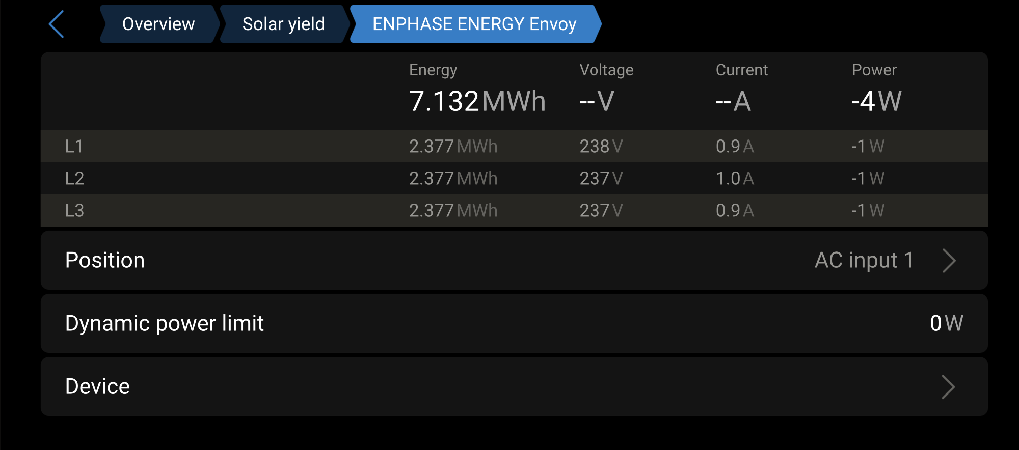

So I switched on Dynamic limiter and straight away the Enphase PV system goes to 0W, see below screenshot:
I tried to switch off again the dynamic limiter and switch it back on after 5 seconds, but the dynamic limiter stays on 0W. I did not restart the Cerbo.
It is here now midday, 12:37PM and sun is shining and energy prices are possitive, not negative, so PV system should produce and sell back to the grid.

I traced the problem to what I think is an incorrect implementation of the DER Capacity information model (model 702) by Enphase. I have yet to confirm, but it seems the WMaxRtg value (maximum power the device is capable) is not a static value, and sometimes it advertises zero as its maximum power rating.
If you reboot the GX device at such a time, or if the network connection is lost and a reconnection is made, it will think the device has a 0W maximum power, and 100% of zero is of course still zero, which is why it gets stuck there.
So short answer: Problem in the Enphase firmware. At least, it looks to be that way. I’ll have to wait until after dark (in the Northern hemisphere) to confirm.
