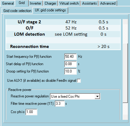

Solved.
In Grid Code Settings, untick “Use Aux 1 to disable feed in”
I will always try and use Aux 2 now for Safety switch use.
