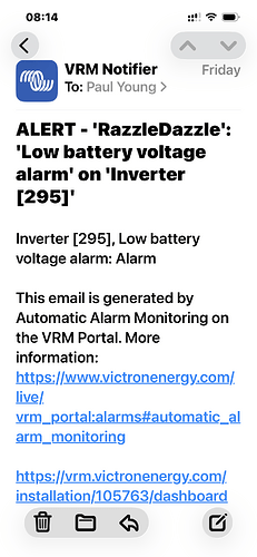

When I turn off the Phoenix 48/500 with the remote switch, it sometimes gives a “low battery” error to the Cerbo / VRM.
Batt is 30kwhr with MPII 10k. Its full.
Firmware is current.
Any ideas?

It is getting enough time to send a low battery error before the control voltage decays. The remote switch is probably turning off the 12v supply to a regulator, and the battery voltage is sensed on the regulator supply, not the battery terminal. This could be a firmware bug, needing a delay in sending the low battery error, if this can’t be set up in the configuration.
