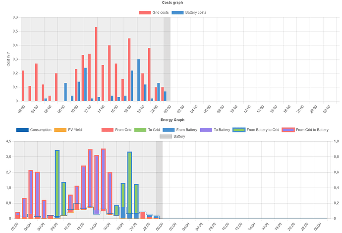

PS, this is what a reasonably performing single phase 40A 230Vac 80kWh MultiPlus II 5000 (+ 8kW HF boost charger) DESS Trade Only system looks like over 90 days:
Why would you say it does not work?

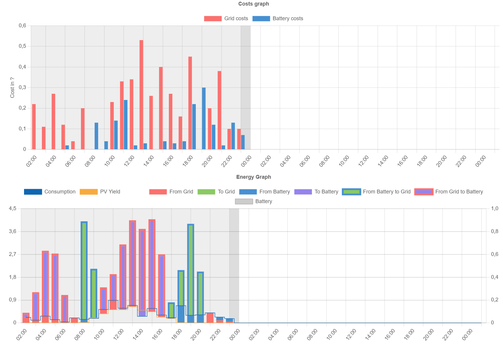

Before: 0/0 (turned off, see screenshot above). NO green mode, I force green mode in hours without expected trading “if (b==0 || soc < 30%) then strategy=green mode (1)"
After:
edit Same for green-mode enabled:

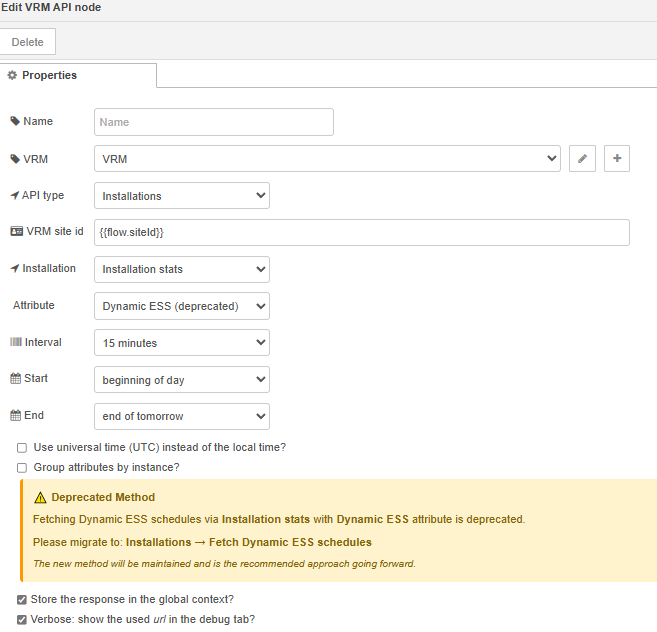

All this can be clearly seen when selecting “Store the response in the global context?” for both the VRM-API settings call as well as the VRM-API installation stats call, and comparing the resulting SOC schedules saved to the global context.
@dfaber could you please verify these findings to be correct and flag a bug in the “installation stats” results. Please do not remove the b_goal SOC and b_goal hour functionality, instead please make the schedule as presented by calling “installation stats” consistent with the schedule object returned by the VRM-API settings call.

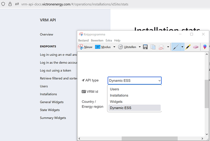

And thank you for the hint on “installation stats”, let me play around with that. I’d love to see VRM and my node-red /dess page in sync some day!
-edit-
The installation stats are probably just that: stats. I cannot post to them even though they seem to show part of today’s schedule. The plot thickens when reviewing the API documentation since there is no mention at all of Dynamic ESS (yet?).

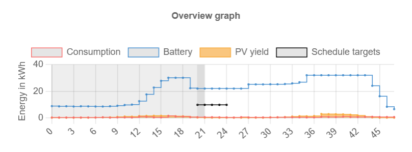

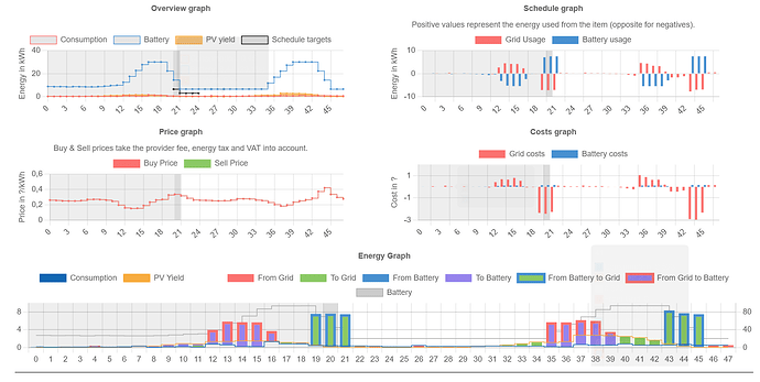

The way I understand it, is that Node-RED DESS will not be updated to function with 15 minute price scheduling. And with that the whole ability to run DESS in mode 4 will cease to work (as-is at least) once the dynamic pricing energy supplier switches over to it. That’s why I started to create that monster of a hybrid DESS Trade flow, to keep DESS actively running in mode 1 (auto) while still using the schedulers ability to calculate an alternative schedule targeted to mode 4 operation (with b_goal SOC and hour functional) and using that alternative schedule to time a charge run when certain conditions are met (price far enough below a running average ánd the alternative mode 4 schedule trying to charge as well).

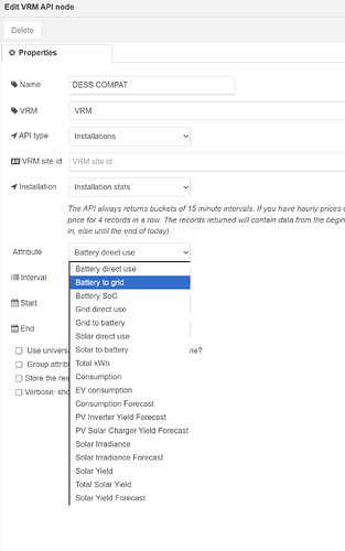

I got that working good enough to be able to leave the system alone for days on a row but not much longer really. Also not getting clarity on this issue took the wind out of the/my sails to invest more time into it as well to be honest. The only area I didn’t really do a deep dive into is the (alleged) ability of VRM-API to somehow feed a new or modified schedule back to VRM for it to be picked up by the VRM DESS dashboard and actual DESS schedule execution engine in the Cerbo GX/ inverter. Should be under VRM-API “Installations" somewhere if I recall correctly. (EDIT: that would be one or a combination of Installation: Get Dynamic ESS configuration, Modify Dynamic ESS configuration and/or Add Dynamic ESS configuration). Unfortunately the documentation on these VRM-API calls seem to be missing or at least to hard for me to find.
Update! Display is coming along, but it is no replacement yet for the old functionality.
edit2 I’m still on firmware 3.70~40 using vrm-api-0.3.3 /edit
edit 3 Updated to 3.70~47 but somehow I only get hour stats now
TODO:
  • Let the schedule-time be based on the timestamp difference (not hardcoded 15 or 60 minutes)
  • Figure out restrictions
  • Clean up the code
/edit3
edit4
  • Use custom query for 15minute data
  • set vrm_site_id as a flow variable
*/edit4

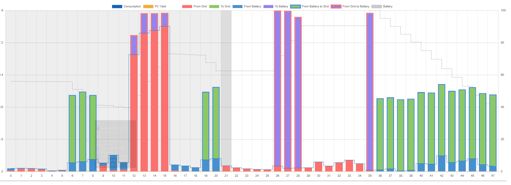

The compatibility code is coming along nicely and it might work with the old flow but I have not tested it. (I compare SOC with previous hour to decide green_mode=1. The variable names are different now.)
It took me a while to decide on how the data should be structed. For compatibility, the old structure would be nice but that is not really compatible with the data we receive now so I decided to restructure it.
Anyway, /dess shows this and if you dare to try: here are all the node-red nodes that have changes (if I recall..)
Old screenshot, still at 60minutes

Did you manage to read 15 minute stats again? On v3.70~47
Yes I did, see my updated flow :grin:
What made the difference? Can you show the API call url (from the debug window, maybe you’d need to enable it in the API node)
The difference is making your own query and use 15mins instead of hours. See the “query” function before calling the dynamic-ess-schedules:
msg.query = `installations/${flow.get('vrm_site_id')}/stats?type=dynamic_ess&interval=15mins&start=${start}&end=${end}`
(code stolen from dirkjanfaber)
Yep I just read it. All I can say to that is: What the freaking duck are those devs doing sending everybody on wild goose chase constructing undocumented querys? This isn’t funny anymore, really isn’t. I don’t even want to list all that went wrong here, the headlights of this trainwreck were brightly shining half a year ago already, from the day of the announcement to phase out Node-RED DESS (May 2).
Relax ¯\_(ツ)_/¯
For a beta implementation I think they are doing quite alright. I do not know if the old, deprecated, node still works but it would not surprise me if it does.
This is us, testing and playing with how Victron sees the future and they will definitely love our constructive feedback. In a beta things will not always function as expected and all you can do is deal with it. (Or fork it and make everything yourself ;-). I love open source!)
I respectfully disagree, waisted 5 months to prepare despite multiple requests to leave some time for testing before 15m pricing starts. Being distracted by the big VRM update hardly aware that a few days later half of Europe will roll out 15m pricing, until I asked about it the day before, making panic chances breaking the old API, forgetting to mention the API change in the change log, breaking the reversal of the broken API, breaking the new API endpoint VRM-API Node not to function as stated in the change log, needing to build undocumented custom querys to bypass the broken API node to access the new API endpoint, Not responding to messages that the API and Node are still broken and not testing/verifying whether the new changes mentioned in the change log actually work as stated / intended. That is hardly an incident, let alone a business as usual kind of thing. IMHO, that’s waisting time and resources on both sides of the aisle.
Well, I figurred it out.
This is what the VRM API Node says:
Check the note:
The API always returns buckets of 15 minute intervals. If you have hourly prices configured for your site, the buckets will contain the same price for 4 records in a row. The records returned will contain data from the beginning of today until the end of tomorrow (if the prices are in, else until the end of today).
This is clearly incorrect, here is the url this call produces:
https://vrmapi.victronenergy.com/v2/installations/xxxxxx/stats?type=dynamic_ess&interval=hours&start=1761004800&end=1761177599
interval, start and end values are incorrect interval should have been “15mins” and the start and end time seems to be UTC
Then inserting your query function (slightly adapted to my flow) between the inject node and the VRM-API node produces the correct url:
https://vrmapi.victronenergy.com/v2/installations/xxxxxx/stats?type=dynamic_ess&interval=15mins&start=1760997600&end=1761170399
Fun fact, if I call the original installation stats set to 15 minutes:
The url will still use hours instead of 15mins:
https://vrmapi.victronenergy.com/v2/installations/xxxxxx/stats?type=dynamic_ess&interval=hours&start=1760997600&end=1761170399
But if I insert the same query function again, it also produces the correct url:
So now I truly wonder why VRM-API had to be changed at all when all we actually needed was the correct API documentation on how to construct the query. Or even better, installation stats actually using the interval selected in the node, as could reasonably expected, why else have it selectable in the first place.
And I hear you and generally speaking agree when you say that:
But this has clearly been a botch job on Victron’s end, with all due respect for their dev’s being extremely time constraint and all, not the dev’s fault but management decision on priorities. But between you and myself we must have spend a multitude of valuable professional engineering hours to figure this all out compared to the time it took a Victron employee to break it. And I do not know about you but I do value my time running a single person start-up trying to make ends meet. The idea that this is an acceptable normal way for us (community beta testers) to cooperate with Victron towards a common goal really does not sit well with me. Victron could at least man up and admit they did botch this job up and I would not have any problems accepting compensation for doing what is basically their job , send us a couple of multiplusses of choice for our troubles would go long way towards making this worth our/my contribution to the good cause. Doing this for free to counter the lack of any regression testing at Victron’s end is not a sustainable cooperation model.
Final words: “If it ain’t broken, don’t fix it”
Here the slightly modified query function:

Weird, my vrm-api node does not show the “Dynamic ESS (deprecated)” item!
I am on 3.70~49 and node-red says the vrm-api node is version 3.6.0. And if I look at the vrm-api.html file on the cerbo it does have this entry.
Am I missing something? Some debug or ‘allow deprecated’ setting somewhere?
See below, the “Solar Yield Forecast” really is the last item.
