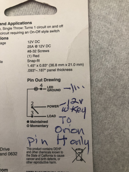

A follow up question. Can I use a switch like this with a light? I have tested so the light works but could it damage something in the long run.
Edited.
The LED will not work if you wire this as a switch between the H and L terminals. The remote terminals have a voltage on the H of 3.3V only and have resistors in so that very little current flows. This will not be able to light the switch.
Works perfect.
Thank you.
