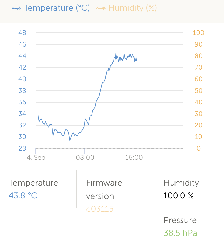

Old/incorrect data in the VRM portal temperature widget
The pressure is not removed from the widget in the VRM portal even though no more data is being supplied by the temperature sensor. The DBUS (dbus-spy) settings also correctly state that the sensor has no capability for air pressure data.
Pressure
Hi Hartmut,
I looked into what your site reports, and there is humidity reported by this device a minute ago. I do agree that 100% humidity constantly is a bit extreme, so maybe you can try and re-configure the temperature sensor?
The sensor still shows 100% in the portal, although it has not been supplying any humidity data to the VRM portal for hours. However, it only shows these at the bottom of the widget. The orange Humidity link is (correctly) missing at the top.
