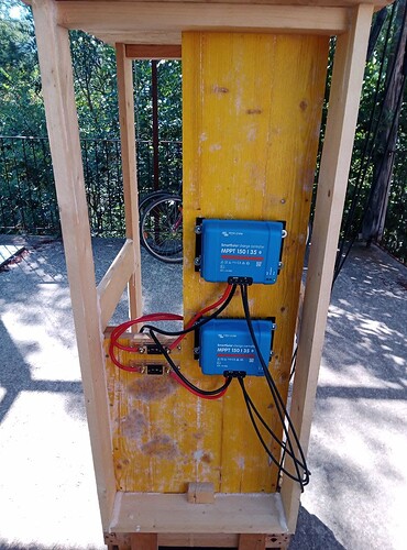

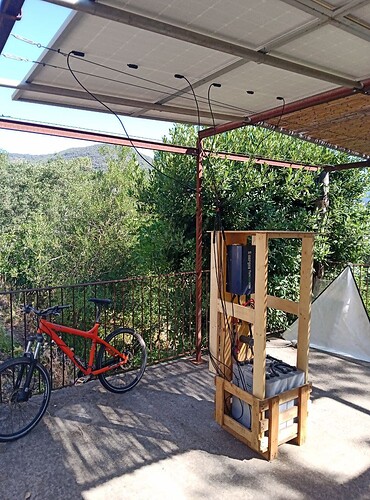

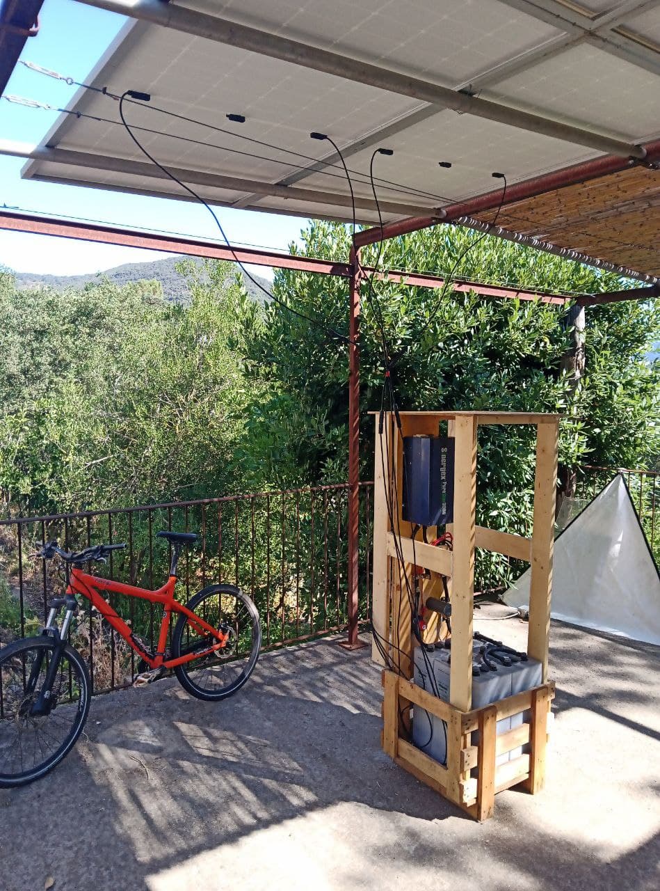

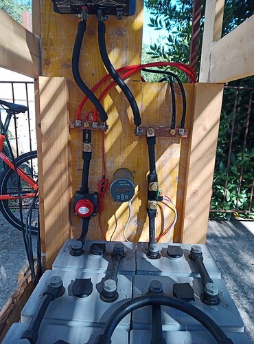

Update on the install.
Have completed building the 12v side using two 150/35 controllers. Have also installed a BMV715.
Now want to fit a relay to protect the battery. Have found this on Amazon - Heschen AC Home Protection CT1-25, Ie 25A, 2 Pole, Two Normally Open, Coil Voltage DC 12V, 35mm DIN Rail Mount : Amazon.it: Industrial & Scientific
Is this relay suitable? Any advice on how to wire it in?
Pics:
