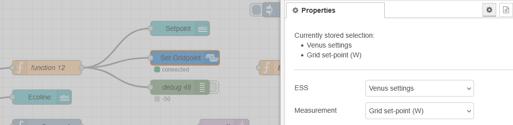

Using the node “@victronenergy/node-red-contrib-victron”, there is an ESS Control Mode node. I select Venus settings - ESS mode, and three options appear. However, none of them is “Keep batteries charged”.
I understand that what I propose is correct: setting the mode to “Keep Batteries Charged” at 1 AM and then switching it back to “Optimized (with BatteryLife)” a few hours later. Please let me know if this is not the right approach. To do this, the only thing I can think of is using the Custom Control node, selecting com.victronenergy.settings and then /Settings/CGwacs/BatteryLife/State. However, I’m unsure about what values should be set here. I don’t find the official documentation.

I use Grid setpoint

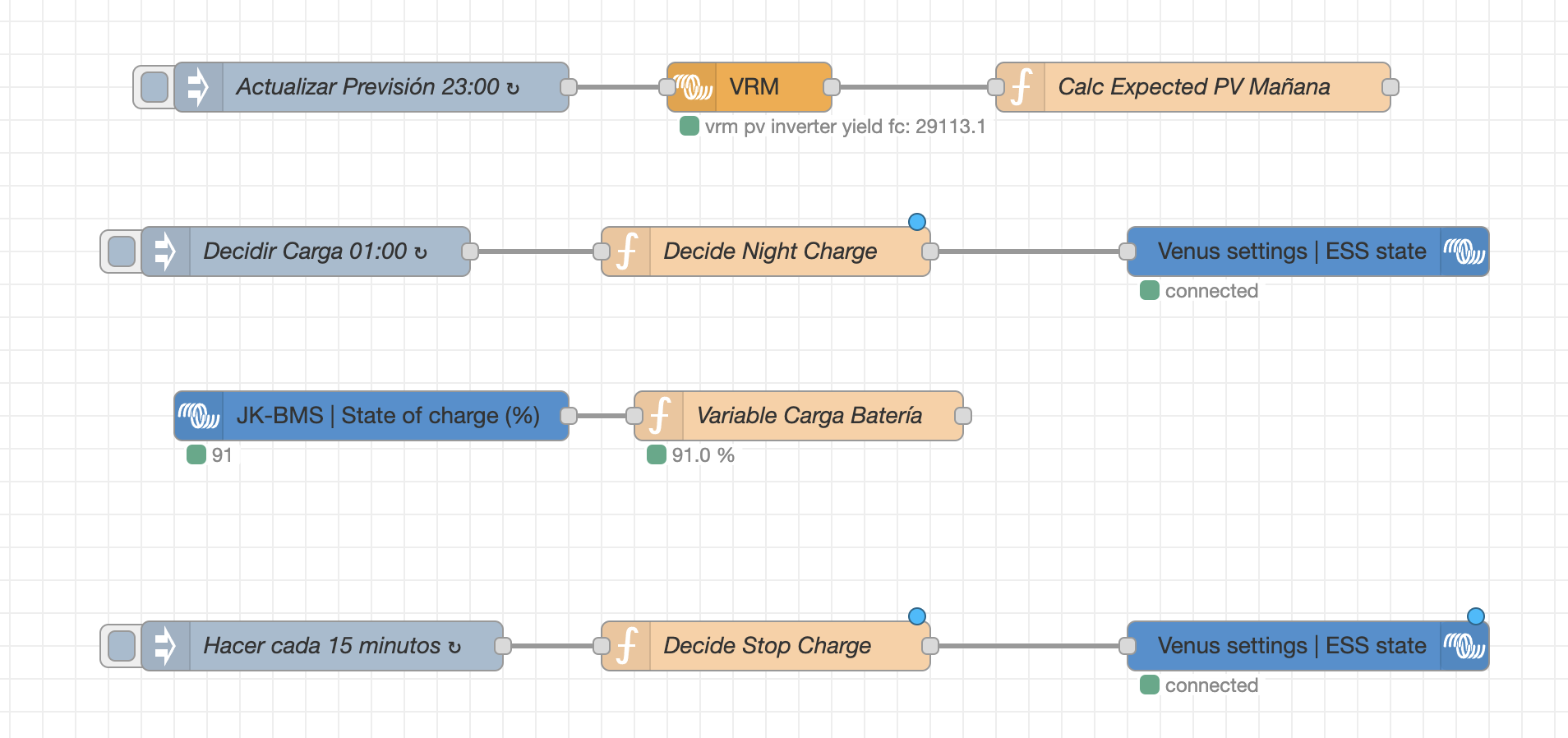

Finally I got it.
At 11PM I read from VRM the solar prediction for the next day. I store the kWh value in a variable.
At 1AM, if the prediction is below 25kWh, I set the ESS State to 9.
I’m reading the SOC of the battery and storing it to an another variable.
And finally, each 15 minutes, I check if the battery is at 99% and ESS State in 9. If this happens, I set the ESS State to 1.
