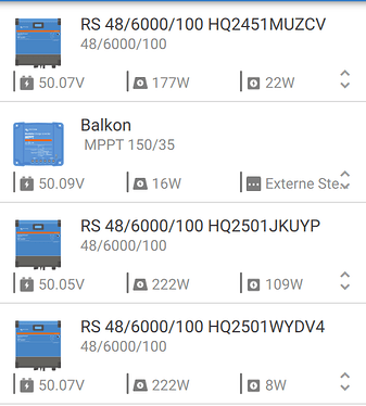

Yes, it’s the Multi RS with two PV string inputs.
The system is configured as follows:
The corresponding setting:
Settings > ESS > Grid feed-in > DC-coupled PV – feed in excess
cannot be applied, as the RS units were configured using VictronConnect and have the ESS assistant installed directly on the devices.
As a result, I’m unable to adjust ESS settings via the Cerbo GX.
