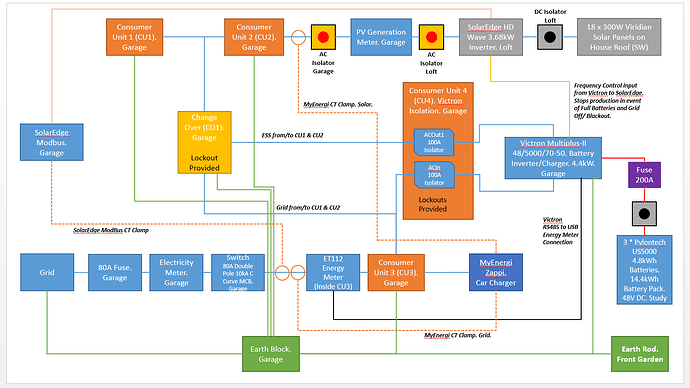

@7hvn Hi show us a Topology of your system, the systems doesn’t sound like it has the charger design in mind, ie you don’t need to force charge the system if the multiplus is after the charger, so I would say either the multi is setup to cover input and critical loads or the CT for the multi is at the main service head before or with the Zappy CT.
Make sure the Zap has load curtailment in order to save the service head fuse as the DNO would not be happy are you able to show us some pictures of this area?

This is the system topology:
The ET112 is direct on the incoming supply and the Zappi is post this i.e. downstream.

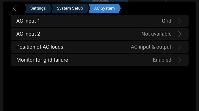

The ET112 is your issue as far as im aware no Victron devices can monitor a circuit without the multiplus wanting to factor it in, Only caveat is the VM-3P75CT can show EV on the VRM but I think this is a limitation rather than a feature but my system is automated so as soon as the car starts charging the system will automatically charge until the EV stops octopus turn it off or I stop it.

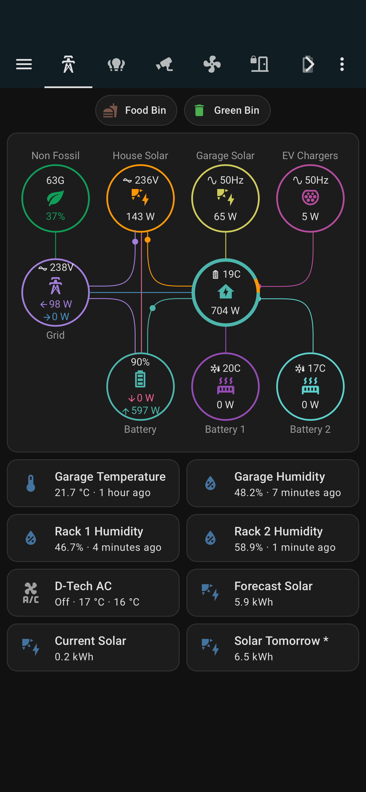

I would need till disable my automation to see if this is fixed in which case I’ll just remove it as I monitor everything display wise through Home Assistant so I can see everything that’s happening at the same time The Victron stuff is for fault finding for me so doesn’t matter that I can’t see that in Victron.
How is the AC part on the multi done ie like below
Your naming of the CU’s needs changing the Zappi one should be 1 and the Multiplus one be called 2 it is here in the Multi CU that should live also depends what other loads you have in Zappi CU must have load curtailment to even think about that as full power on both your on the door step of that 80amp fuse.

Loving your HA dashboard! One day I’ll spend some time on mine… I hope… :crossed_fingers:t3:
@7hvn Thanks it’s taken a while, Yes it’s as I thought your multi is also covering everything in in the Zappi CU, do you know if it’s ACout1 or ACout2 that the multi has been wired? Changing that setting to the way I have it will not monitor anything in the Zappi CU so that ET 112 at the location should be fine just a change of setting But be aware all loads in that CU will not be covered by the multi
All load is on ACOut1. Nothing connected to ACOut2.
What is in the CU with the Zappi? Chanting the setting to Out only should stop it covering that Zappi CU
Inside CU4 there is:
  • ET112
  • Direct House Power (For when the change over switch is set to Grid rather than MPII). Feeds CU1 + CU2.
  • MPII Power.
  • EV Charger (Zappi)
  • MCB for Surge + Surge protector.
So keep to the naming you have there otherwise it’s going to be hard work for me to keep track just label the CU’s after it’s all sorted, so CU3 is just the ET112 Zappi and the multis input MCB/RCBO if so change that setting and test it should not deplete your batteries now

strange just remind me on layout again, is CU3 connected to the multi or is it on the Grid? Do a comparison with mine. But the EV charger should be the first thing in the link from the grid ie before the multi
