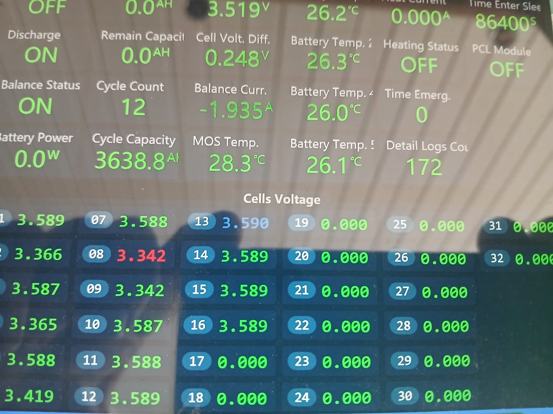

Here they are. Both batteries are on the same settings. Hope this is what you mean
Cells are very well balanced. 0.008 defiacion max. But during changing it can get up to 0.281
A good starting point for the settings.
Disable DESS until battery fully charged and balanced.
Start Balance Voltage is set way too low. Change it to 3.42V at least - in the different sources you will find also 3.45V.
RCV Time is too long. Set there 1h.
That’s your issue. One or more cells are reaching OVP, others are way behind.

Ok, more info from today. I was watching it like a hawk.
The divergence of the cells starts at 97% charged. The cell difference is during charging 0.020 or less. Then it starts to clime fast, until it reaches 0.251 or so, when of course ovp happens. This happens within 10 minutes or so.
It is always a different cell.
Any hints?
Disable DESS. Enable Keep Batteries Charged for 2-3 days, until they will properly balance.
Ignore the errors, it only means that protection is working as expected.
After few days of top-balancing, bank should work as expected as the complete solution. Now for sure I’d try with above - settings are somehow good. Depends on who you ask, other parameters are commonly have lower or higher values - but marginal from your current setup.
EDIT: I’d even disconnect second bank, keep first connected until top-balanced, then switched and do the same with the second. Again, only one bank during top-balancing. After success on both, connect them together and start using + checking the situation.
