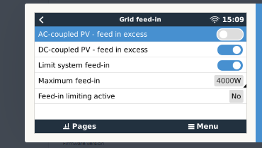

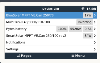

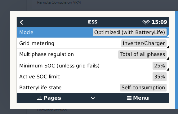

Have this system behaving a bit weird in the sense when it tries to feed into grid at roughly 1kw feed-in power it disconnects AC, even though it is well within limits. Any ideas anyone?
LOM issues and sometimes grid impedence.
Is it the same one as the post with the energy meter over 100m away?
Hi @lxonline. No, this is another installation we have. Let me try disable LOM and revert.
