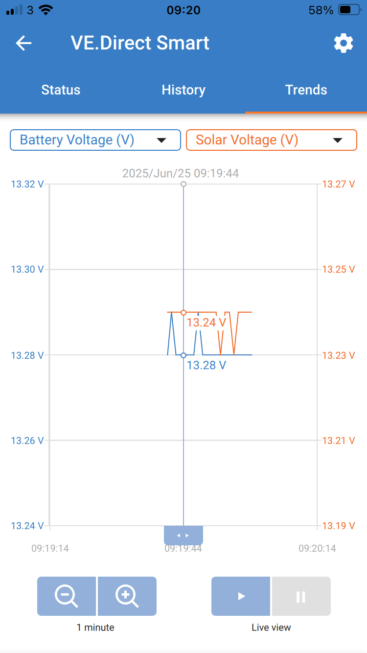

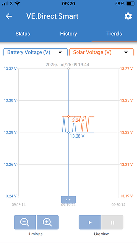

There are no other devices connected. Smart Shunt and Blue Solar mppt only. Battery BMS doesn’t communicate with victron devices. The Smart Shunt is showing battery voltage ok.Victron VE direct showing solar voltage at 13.24 volts and battery at 13.28 (image attached)
