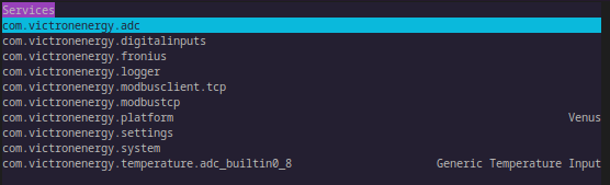

To check this you need to connect to your GX device via SSH. Then you can use dbus-spy to look at all of the dbus services.
Mine come up as:
Nothing connected to the Cerbo, but .settings is there.
To access those parameters via Modbus, you will probably need to use UID=100. even though it’s not shown in this list:

thanks for your support, but I am missing the service “com.victronenergy.settings” in my Cerbo. you have it in your list. Did you installed it extra or did it came with the system from the beginning ?
No, the .settings service is there, but may be hidden. Did you try connecting to the Cerbo via ssh and using dbus-spy?

All of the core Cerbo services IF they have Modbus table entries use UID of 100. Plug in devices, like Inverter, MPPT, thermistors have different UID’s and these are shown in the Cerbo modbus services list. Some (incorrect) values for these services are given in the GX-modbus chart. Use the values that the Cerbo gives you.
Root access via SSH is useful if you are developing, and allows you to do and check on a lot of background stuff that the average user never gets to see. For this, you need a pc or laptop on the same LAN (network), and if it’s windows you need to download open ssh for windows.
From there, as described in the root access document, you need the ip address of the Cerbo to open communications. dbus-spy is a utility program (built into and running on the Cerbo) to monitor all of the DBus service values, and in some instances to modify them. ssh is a secure remote access terminal - this gives you a peek hole into the remote processor that is the Cerbo.
