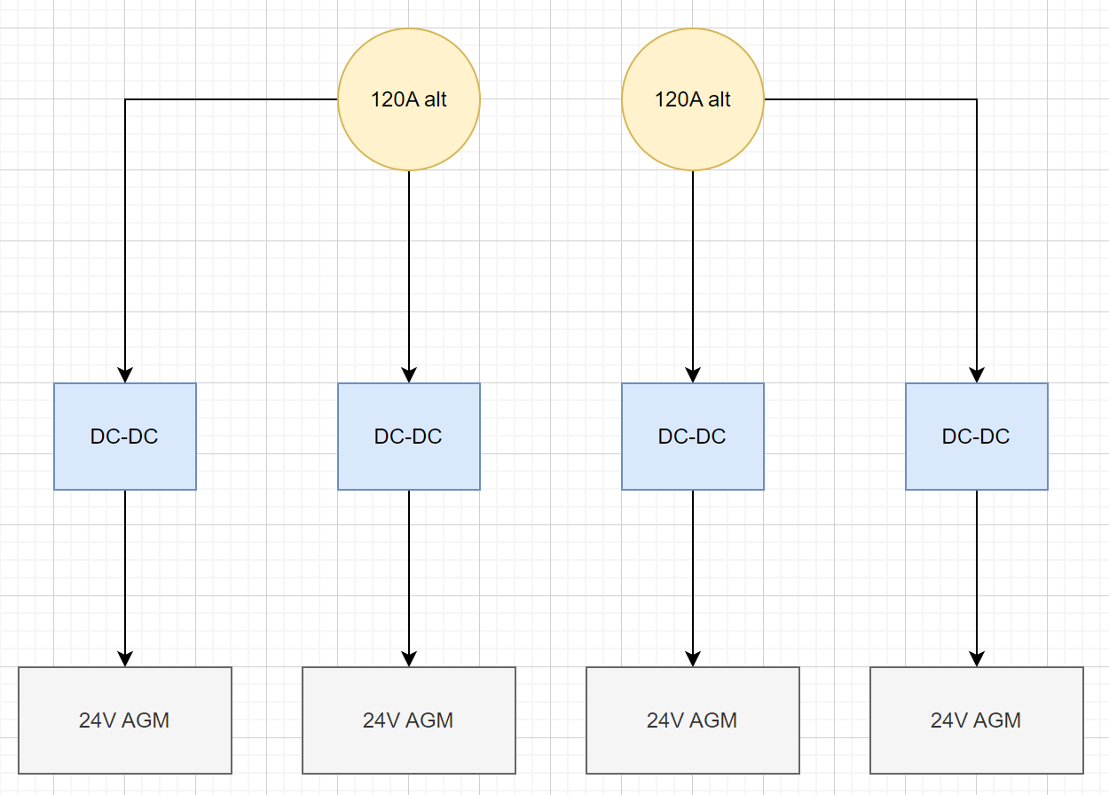

Hey Bruce
One option could be to just put isolated DC-DC chargers from the two respective alternators to the 4 respective batteries? This way they are elctrically seperate but all still charging, there is also the Orion 1400 that does 50A, but is not isolated
Something like this, then you can still add seperate AC chargers to each battery?
@JakesNell That is wrong, the Orion chargers are battery to battery chargers, the alternator outputs need to go yo a battery to allow proper dynamics for the voltage regulators, the batteries buffer the voltage. Otherwise you can end up with voltage cycling as the voltage control in the alternator regulator fights with the voltage control in the Orion input. People who have tried this report problems.
@BruceBaby Jacques is going along the right path here, just not properly implemented. Assuming all the negatives on the 4 banks are commoned up then I suggest you charge the domestic bank from one alternator and charge the starter battery from the second alternator. Then install a pair of Orion XS 1400 chargers from the starter battery to the thruster batteries. The Orions can be set up so they do not draw the starter below say 13.0V to maintain charge on the starter. The high current demand from the thrusters can never draw from the starter battery.
Aah yes, I missed that, you need the “starter” battery as a buffer or pool to keep the voltage into the DC-DC stable, my bad

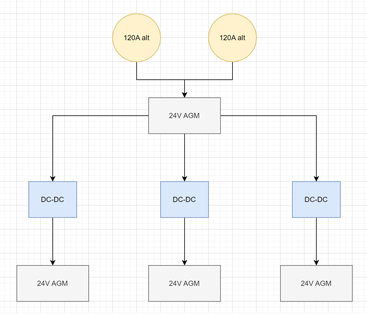

Hey Bruce
Something like this could work, but then the starter battery bank would need to be rated to accept 240A of charging and 150A of discharge potentially. @pwfarnell does this seem more feasible?
It is certainly feasible to power one bank from both alternators, as with @CRuMbS install above, connect them to the house bank as that should be the largest bank and then charge the other 3 banks from this. You would find that due to minor differences in voltage measurement and voltage drop that one of the alternators might take the lead and the other idles more. However, with external regulators like the Wakespeed WS500 and some Balmar version, these can be interconnected to make the alternators share load.

Thank you again everyone, really appreciate everyone’s input here. I have just jumped onto hour sketch @JakesNell and added the AC side of the equation as well. Does the sketch look ok to all?

Yup, that looks good.
You could put 4 BMVs in with shunts on all banks, then you’d get good data on each bank.

Hey Bruce, yes I believe that should work just fine, the Skylla-I comes in a 80A and a 100A so not much of a difference, if you want the tiny boost of speed then you can do the 100A version to charge up faster. As @CRuMbS mentioned you can do seperate BMVs for each bank to get bank specific SOC, amps and voltage.
