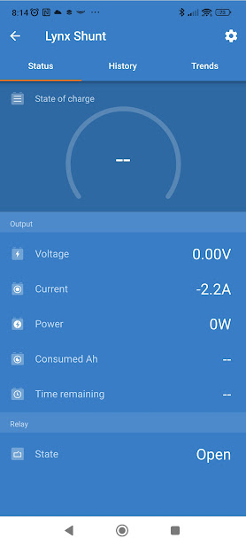

I am experiencing a critical issue with my Victron Lynx Shunt VE.Can 1000.
After performing a Battery Voltage Calibration in VictronConnect, the voltage reading has become stuck at 0.00V. Since then, the shunt no longer reports the correct battery voltage.
I have already tried the following steps:
Performed the calibration multiple times with the correct battery voltage.
Fully powered down the system and reconnected.
Downgraded firmware to v1.08 and repeated calibration, then upgraded again to v1.10.
Performed Reset to defaults.
Verified with a multimeter that the correct voltage is present at the Lynx Shunt terminals.
Despite all attempts, the Lynx Shunt still shows 0V.
Could you please advise if there is a way to restore the calibration values (e.g. a service tool or special firmware), or is an RMA / replacement required?

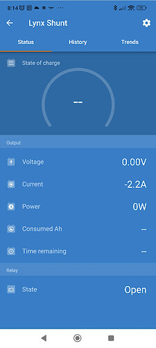

No, unfortunately I don’t know the solution. Everything was working perfectly. But I tried clicking the Start button (Battery voltage calibration). I entered a more precise voltage value on the bus. And after that, my Lynx Shunt turned into a brick. Now it always shows 0V, and on top of that it doesn’t display the SOC anymore.
I tried setting a different SOC value, synchronizing to 100%, and starting the calibration procedure again. But the voltage is still 0V, and the SOC resets again. At the moment, the Lynx Shunt only shows the current, with 0V voltage and 0W power.

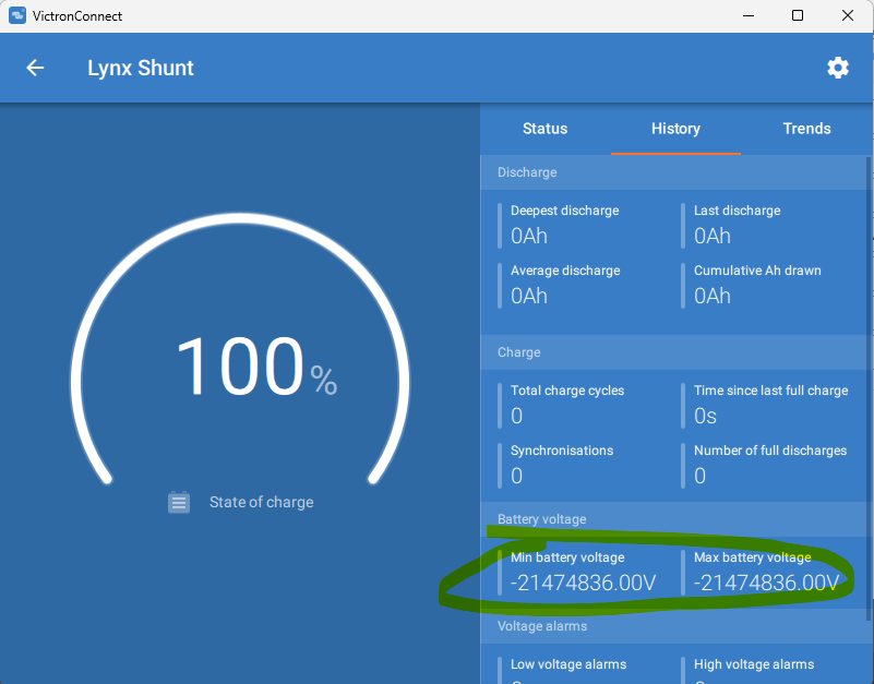

I hope someone from Victron reads this post and understands the urgency on this and the implications of not having this issue addressed promptly. I forgot to share something interesting (attached screenshot). After resetting all the historical data, the battery voltage is now showing negative values. Something is definitely wrong with the firmware and/or VictronConnect app. I also verified with a multimeter that the correct voltage is present at the Lynx Shunt terminals. Hope this helps Victron representatives addressing this particular issue.
