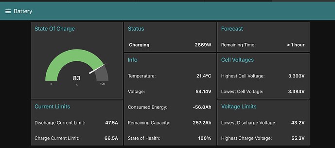

I am working on a dashboard in NodeRED and I noticed that two values (lower left) are different of what I have set them to in the JK-BMS settings (50 and 70). No idea why. What am I missing here? Anyone else has an idea?
Note that I only started to use NodeRED less than a month ago and it may look a bit redundant, but this is what I came up with. Got to learn new stuff. Fun to see something going forward. TIA
JK BMS reports 95% of the limits you set to the inverter.

Yes these values are exactly 95% of what I have set them to under the JK-BMS settings. They can also be found at JK-BMS → Parameters.
Well. I guess that they want to stay on the safe side. Since charge/discharge values appear to jump up and down a bit, At least that’s what I observe here.
Conclusion. What I see is normal behaviour. Not a mistake/some rookie error. So I hope, Haha.
