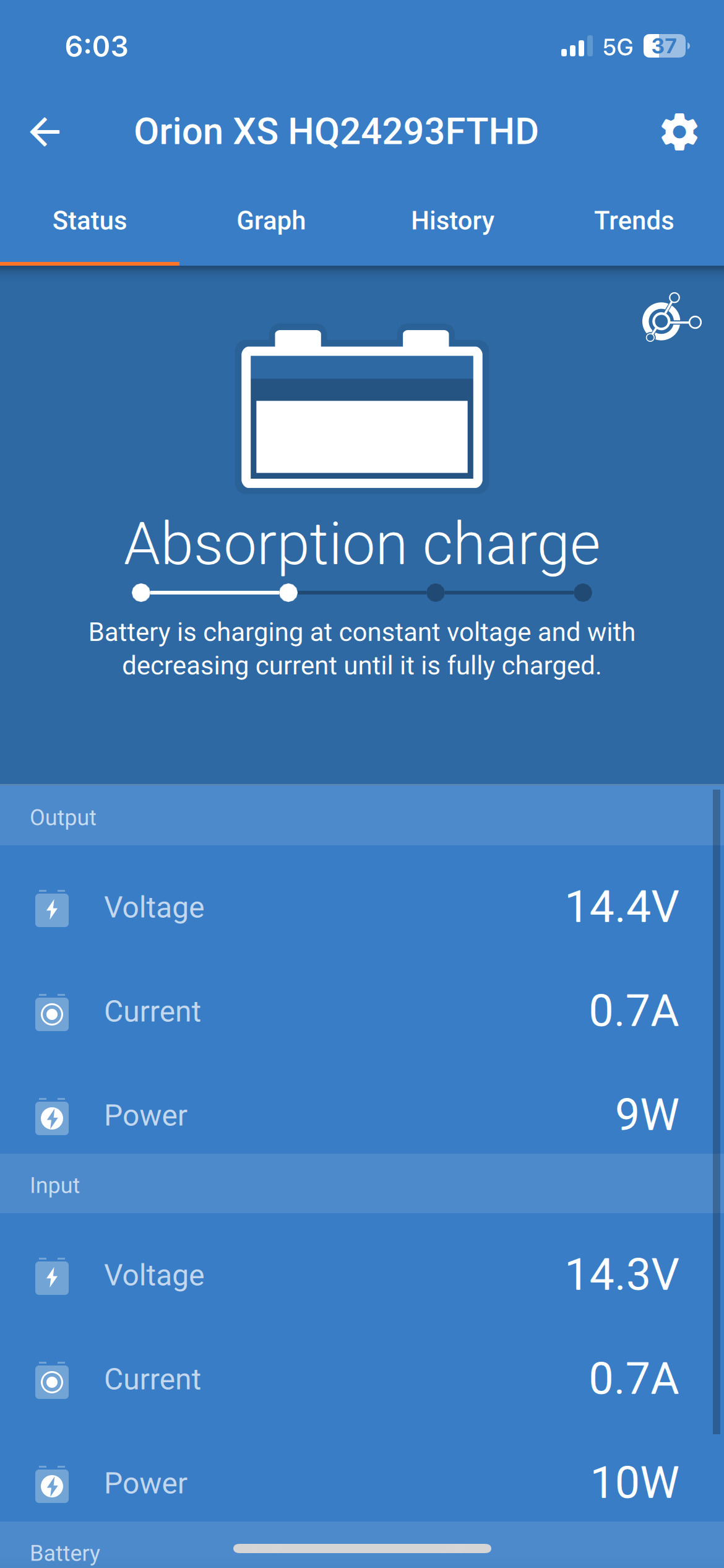

When Van is off.
When Van is on.

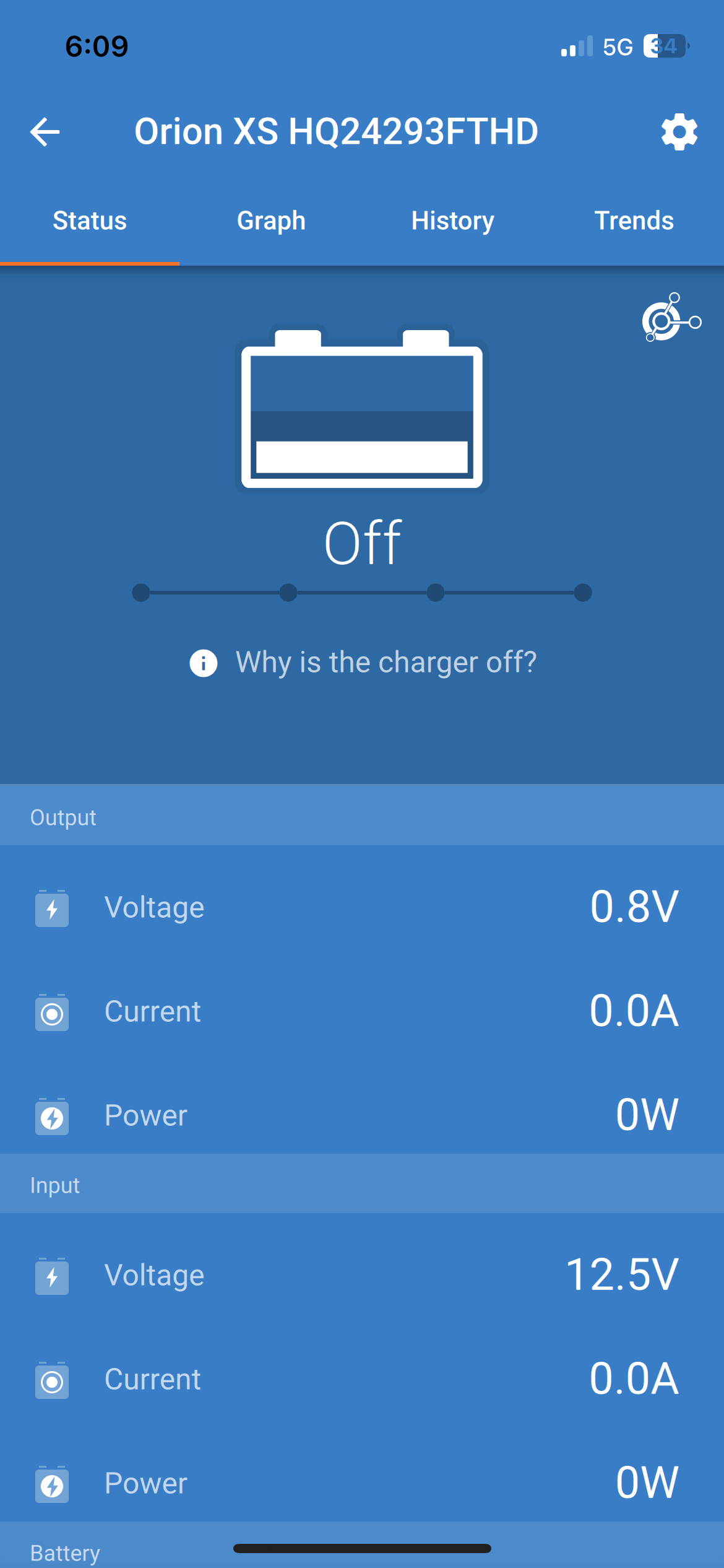

When Van is off.

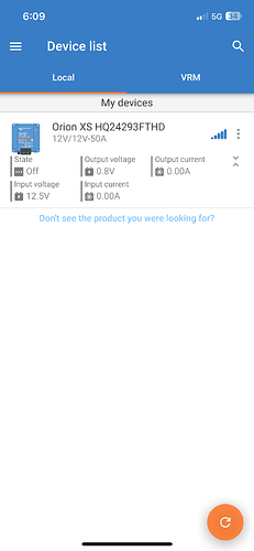

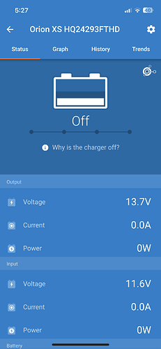

This last screen shot is shore power disconnected, solar off, main switch off and Van off. But, the Orion XS is still on. Shouldn’t this device also be offline from my devices since everything is off? All other devices are offline. Is it pulling power from the chassis battery?
I doubt it is the Orion draining your battery as the stanby current drain is <1.5ma 144ma in 4 days. Do a load test on your starter battery and see if the CCA is holding up, might have a faulty cell causing self discharge.
Depends on where the main switch is located. But i guess that only cuts the auxiliary battery.
When either side of the Orion has power, then the internals are powered.
But i also doubt that the Orion is the (main) issue here, its detecting the engine shut off correctly, so power draw is very minute.
