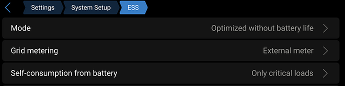

Do you have a gridmeter? Put the EVCS on AC-in and self-consumption from battery on: only critical loads.

If you don’t have an external meter, you don’t get the option self-consumption from battery

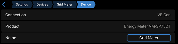

I use a VM-3P75CT as grid meter

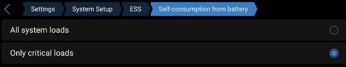

With an external meter and EVCS on AC-in, you can choose how to charge your EV. Self-consumption from battery on: all system loads, the EV will be charged form the battery. With: only critical loads, the EV will be charged from the grid.
Thats exactly what I need! Meter ordered.

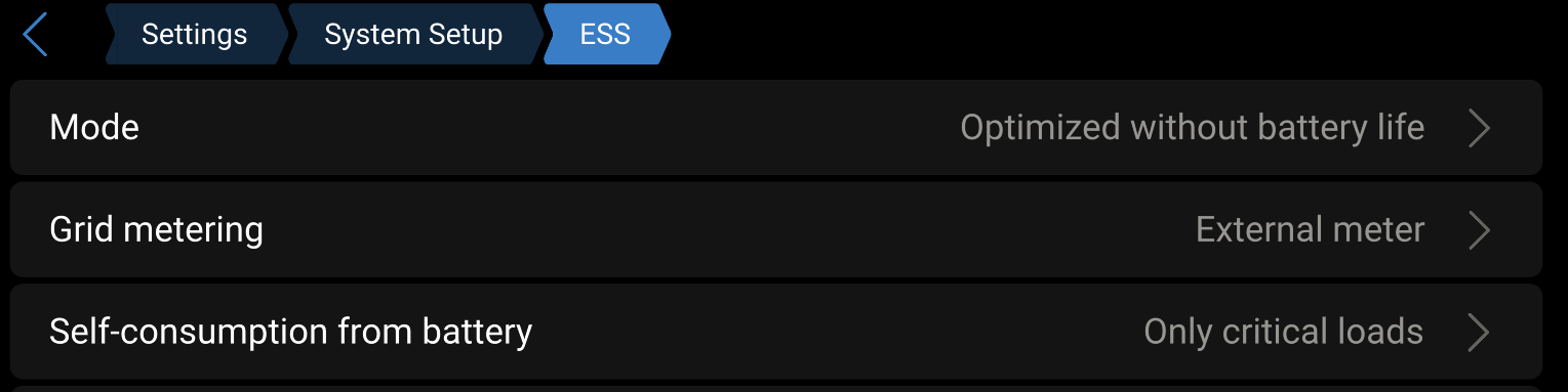

I have the same issue with EVCS draining my batteries.
But I dont have this Option “Only Critical Load”
I do have an External Meter but its a Shelly 3EM Pro
