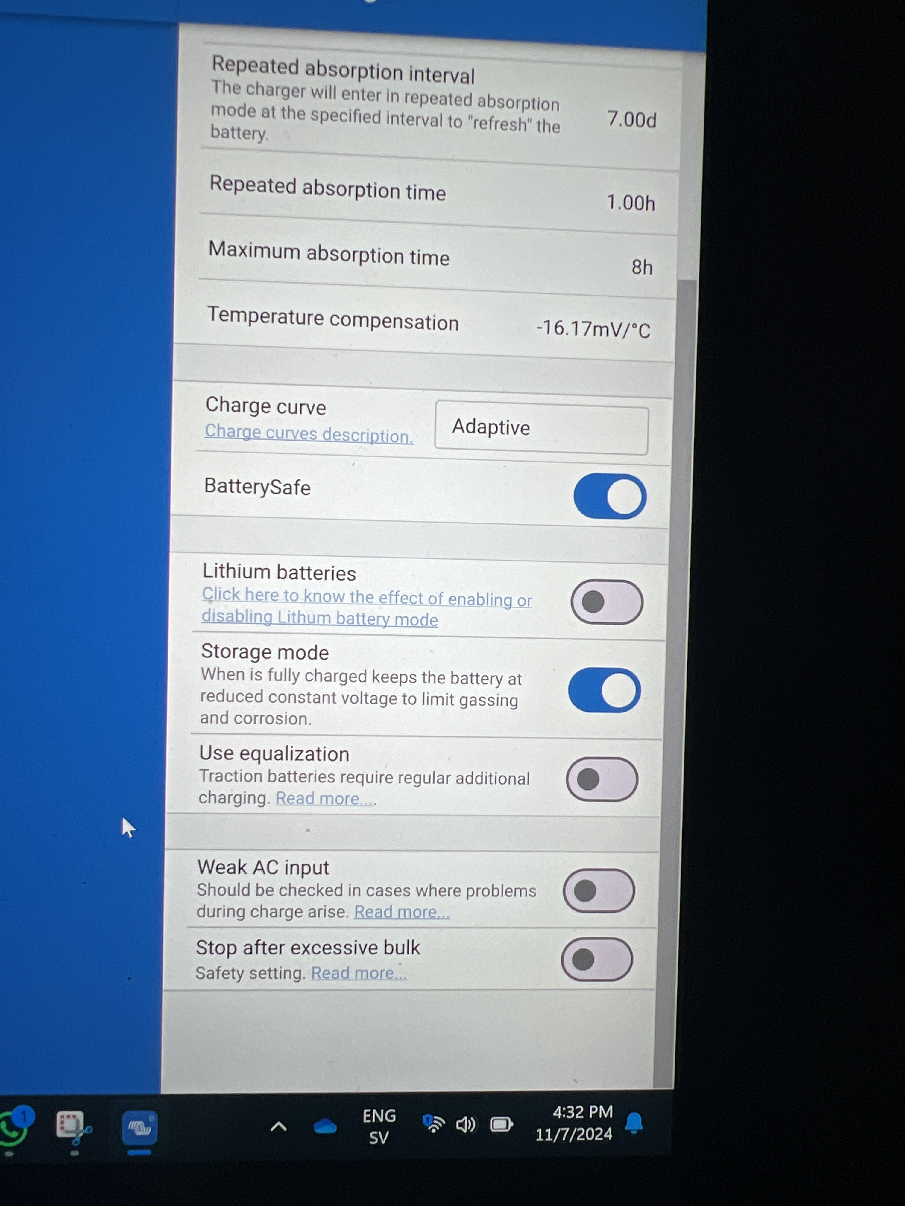

Hi,
I am using Honda eu22i for charging 200ah lithium connected with multiplus compact 12/1600/70a
But I see in the app that input ac doesn’t increase more than 860 W - even though generator supports at least 1600w.
Any idea why this is happening?
I tried with Turing eco mode off in generator but inverter still does not draw in more

Pls show the settings for the general and charger tabs.

Under charger settings your charge current is limited to 52A (even though its actually charging at 53A).
FYI you will never see more than 1kW when charging (70A x 14.4V = 1008W) plus a bit for conversion losses.

Ah yes, ok…so that’s about it then.
