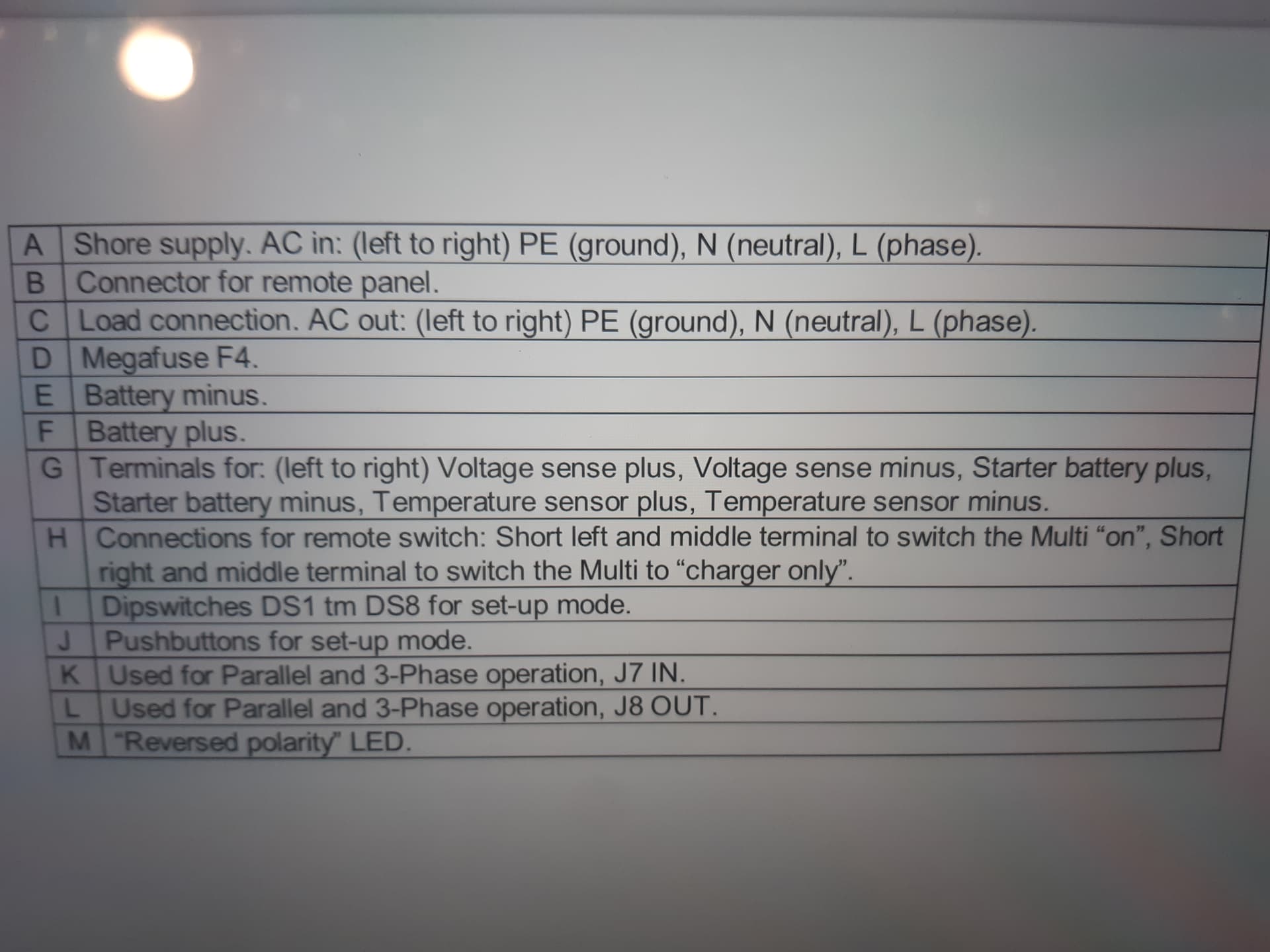

Thanks again! I think your right, mine must be older.
The Dipswitches Ds1to Ds8 (indicated with “I” in foto) are definitely there .
They’re in the left upper corner.
The pushbuttons for set-up mode (indicated with “J” in foto) are not there.
So all the manuals must be younger.
Is there another way to find even older manuals? That would be very helpful. Or do you have any other suggestions ,I would be very grateful .
Do you think I can’t use the Mk2 to connect?
Then I try to send it back.
Thanks for your time
