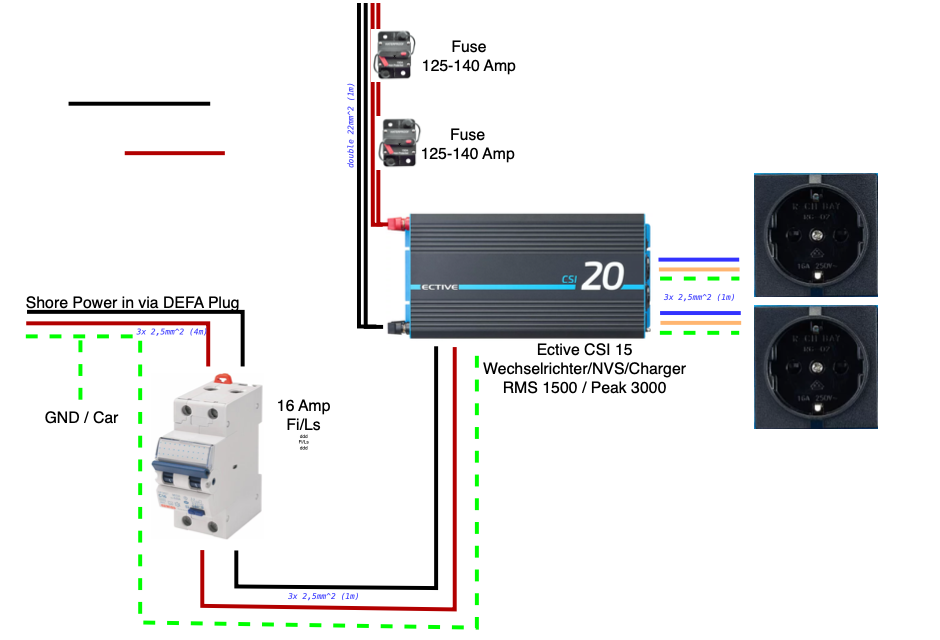

Hello !
I am about to build my first RV / Camper Van with all the electricity needed inside. It’s main components are victron, so i’d say it’s victron based, but sadly not all of them can be at this point. Maybe in the future, or maybe with your suggestions more Victron will be added.
You’ll find most of explanation within the diagram i assume, questions and recommendations are very welcome.
Charging: MPPT 100/30 on 2x 200w Solar Panels + Orion XS 12-12/50
Van is a Peugeot Boxer 2019 with Euro6-TEMP.
Please let me know if this is working, wishful thinking or just dangerous :smiley:
Much appreciated!
