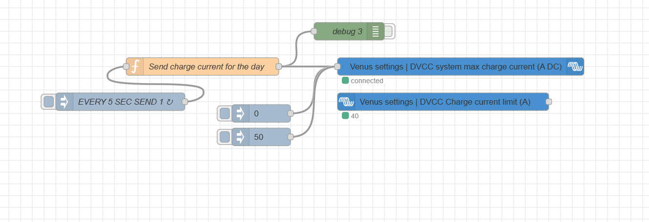

That’s a big ask. I run 3 ESS on the same meter. I use this Node-Red flow to disable the charger overnight. 2 units are mostly solar soakers for the big one, and may not charge from excess solar if there is none. I have a mix of MPPT and AC-coupled solar.
The flow is in the text file if anyone needs it.
SET CHARGE CURRENT FOR THE DAY.txt (5 KB)
