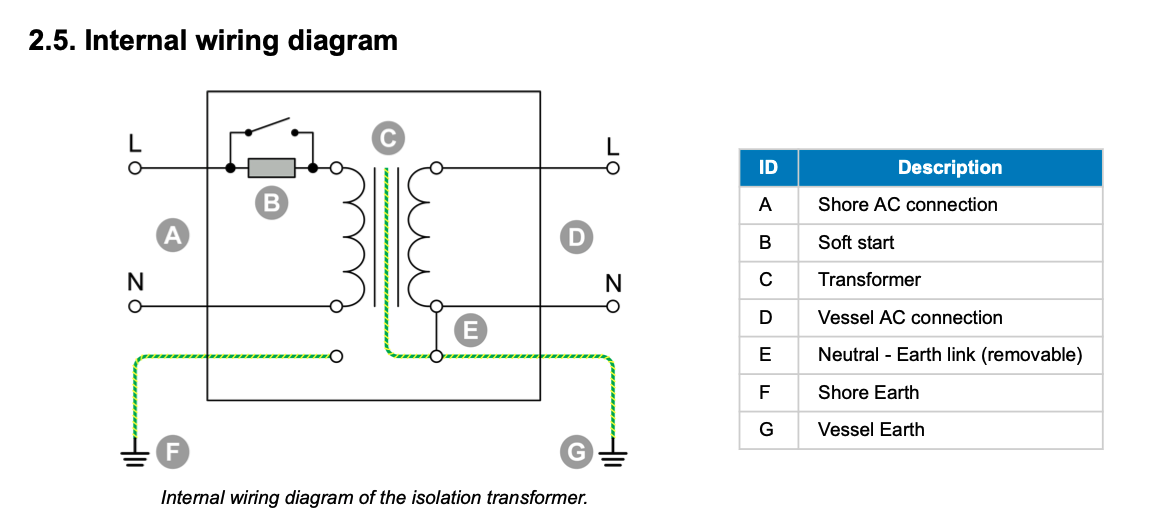

A Victron 3600W Isolation Transformer may be of help here, by connecting the L1 and L2 from the L14-30, you’ll get safe 240V single phase power if you ground the neutral coming out of it. https://www.victronenergy.com/upload/documents/Datasheet-Isolation-Transformersa-EN.pdf

EDIT: However, I am concerned about the 1.05x voltage increase. If you put in 240V, you will get out 252V, which is awfully high for AUS. So maybe that isn’t such a good idea. Also the 240V input is more than specified in the manual (230V).
If you use the Victron autotransformer instead, it can step up the 120V from the L14-30 (pick a leg) to 240V. You will be limited by the continuous 28A US-neutral limitation of the autotransformer. You don’t need a multi or Quattro. Put L1 and Neutral of the L14-30 into the AT, and get out 240V. However, the voltages are not isolated, and this is probably unsafe. Because if you relabel one of the output lines as AUS Neutral, it will have 120V relative to the frame of the vehicle (assuming Ford bonds the ground and US neutral, I don’t know what they do).

Electrically, going through the AT will certainly work, you will get 240 VAC out from 120V in. For that matter, just using L1 and L2 without the AT will also work electrically. But neither are safe from a grounding perspective. Which is why an isolation transformer is better.
If you can ensure what you plug in does not assume Australian “Neutral” from the AT is grounded, then you won’t have a safety issue, but I don’t know how you could know in advance. Despite this, I’m sure people do this sort of thing and never notice. See if anyone else comments here, it is a common issue.

so wire the transformer the other way around, using 240 input to the output of the transformer, and your appliances to the input side. This gets you a 5% drop, or 228V, much closer to the standard 230V.
You know, a transformer does work in both directions, it is a passive device.
That would be an outstanding idea!
Except that Victron put a soft-start on the primary side, not sure how that works in reverse.
And that they ground the secondary side internally, but that can be removed.
If necessary, the actual connections to the transformer can be moved, however this would probably invalidate warranty.
The soft start can also be bypassed if needed, though each of these requires a higher skill level from the installer.
