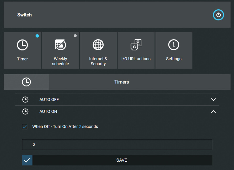

As I wrote, it’s working solution for my Stellantis car. And YES, I’m using this solution with shelly to wake up my car.
I’m not using node red, I’m using OpenHAB, but doesn’t make sense which SW will send a signal to Shelly.
Shelly is configred, that all the time is ON (means contact is closed and CP communication is working). Only when OFF comes (from node Red or from shelly app or OpenHAB ) = CP communication is disconnected, timer starts and after 2second is ON again = CP connected = car wake up. After this wake up you have aprox 20seconds to start charging otherwise car will go into sleep again.

First I will send command to the shelly “open contact”. Then car and EVCS thinks that cable is disconected. But after 2 seconds is contact closed again automatically by the shelly (timer function) so for EVCS is car connected and also car will wake up for 30sec. So you have this time to send charge command into EVCS.
