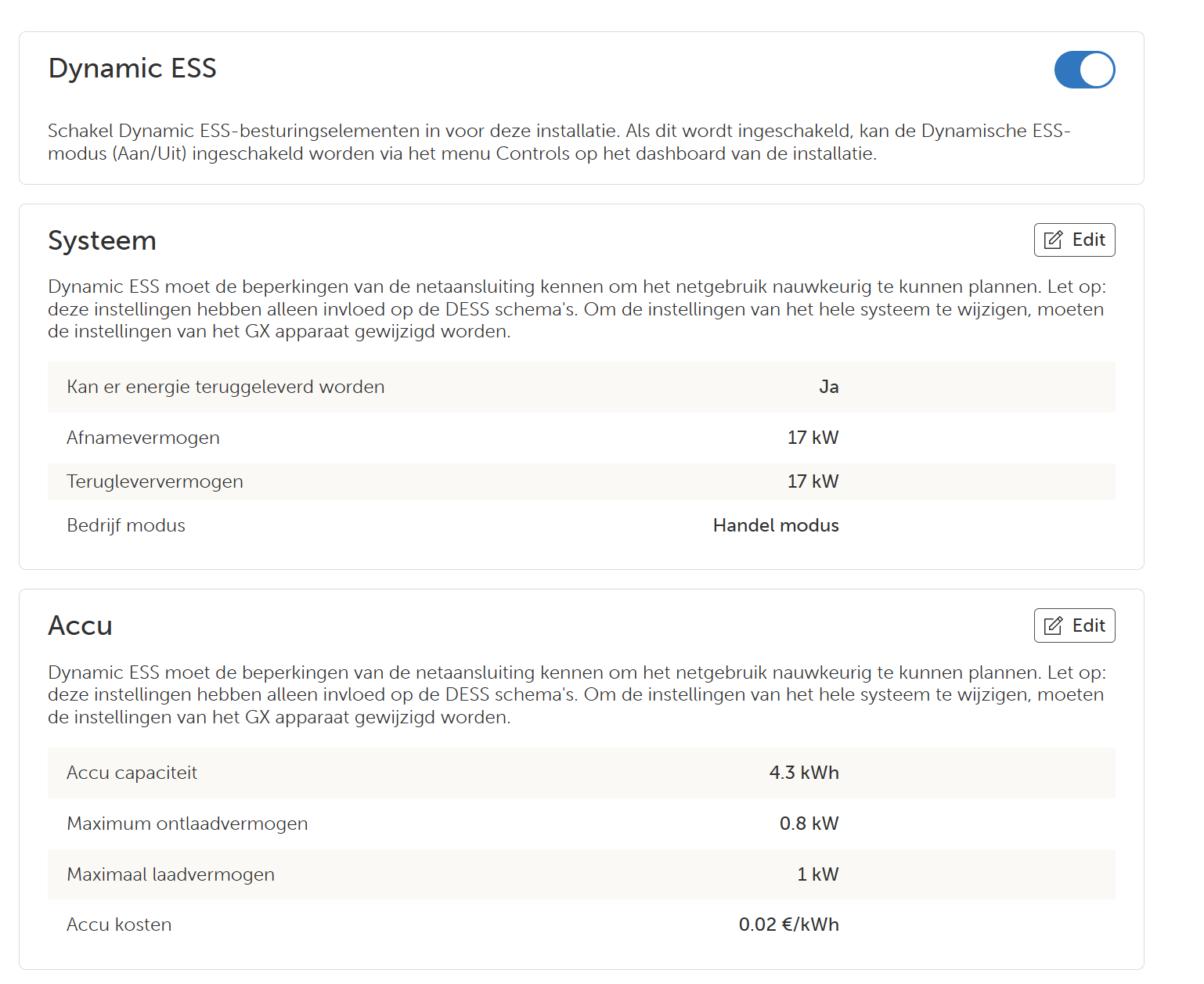

Somehow since three days ago my energy prices wont show, it states “Dynamic ESS - Off:
I have Dynamic ESS on in my settings in vrm:
My Cerbo GX has internet connection, remote console works via vrm.
Does anyone know how this could happen?
Greetings,
Arjan

There is a second switch to enable DESS, in your VRM on the top right corner you can open the controls menu and check it.

Have you checked the price formulas? Recently there was a switch from 60min to 15min intervals for dynamic prices.

My provider only does 60 minutes energy prices, in my vrm options it’s also on 60 minutes.
I have noticed before that it reacted to 15 min price changes but it could be that was before the 15-60 minutes option was available in vrm.

i tried changing it to 15min (even though my provider does 60min) and that solved the problem!
Thanks for pointing me in the right direction
