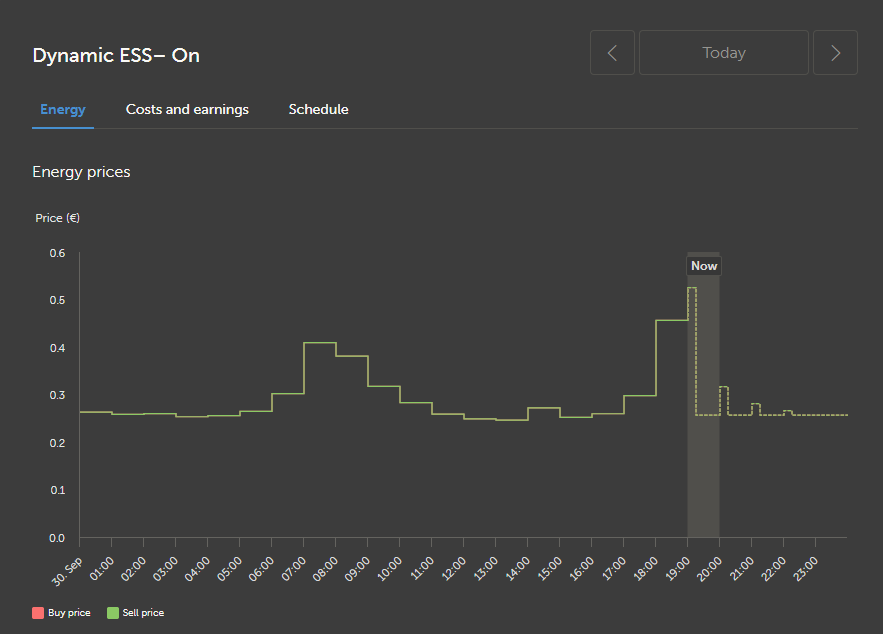

Since the quarterly hour prices for tomorrow, October 1st 2025, are known (as can bee seen in VRM Portal), I’m experiencing a fetch error on my VRM API node in Node Red for Dynamic ESS. Other API fetches work just fine.

The API works again but is now returning averaged hour prices

Is there some sort of latency for the settings to change? I changed my DESS settings in VRM to 15min a few hours ago and in VRM the price is OK, but vrm api in node red only gets hourly prices?
