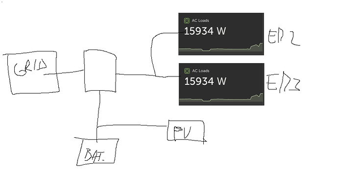

Hi, I know you can have more than one energy meter in victron, now I have one as the main one for GRID and if I add two more after main (one for house 1 one for house 2) Can I see both in VRM? or I can only see one where it will be sum of both, I would set them as AC load.
If anyone has it, can you send a photo of the VRM. (photo for understanding)
and for other setting options in the cerbo GX for the energy meter, such as a heat pump etc. , vrm probably works the same way, right?
my idea of ​​what I would expect in VRM

no evcs yet, probably the best idea as a way to recognize it at first glance, but it would be good if they added this, especially since there is an option to choose what it measures, so I’m surprised it’s not there

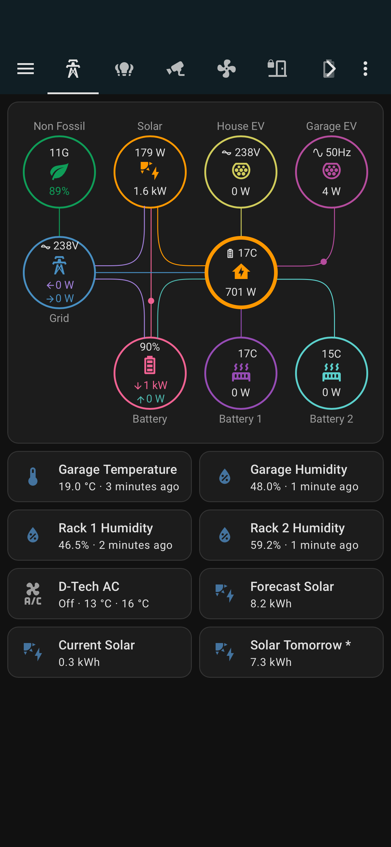

Alternatively you can do a dashboard in Home Assistant if it’s just a nice visual you require like I did as I have too many thing that I want to monitor at an individual level
