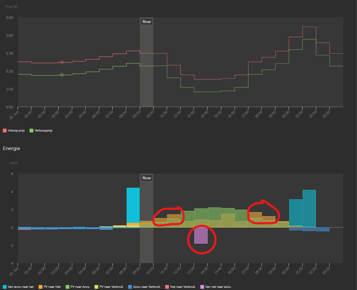

I’ve been using Dynamic ESS (Trade mode) for a while now, and in most cases it works very well and the behavior is understandable.
However, today I noticed something odd:
According to the forecast, the system plans to buy around 1.8 kWh from the grid, even though there’s at least 2 kWh of solar excess available around the same time (clearly visible as PV → Grid in the energy graph).

Hello @favado , welcome to the forum. You may want to read along with use here: Another Strange DESS behaviour - #13 by UpCycleElectric
I tend to agree with that statement. I seems to me that most recent DESS development has been focused on solar systems and self consumption in Green mode with less attention to Trade mode. I am testing with Node-RED flows to make Trade mode be more opportunistic in its buying decisions which makes it behave more in line with how I’d expect it to do. I too tend to believe the best economic performance (low cost, return on investment) is to be had with a well behaved Trade algorithm even with solar production added on top of that.
