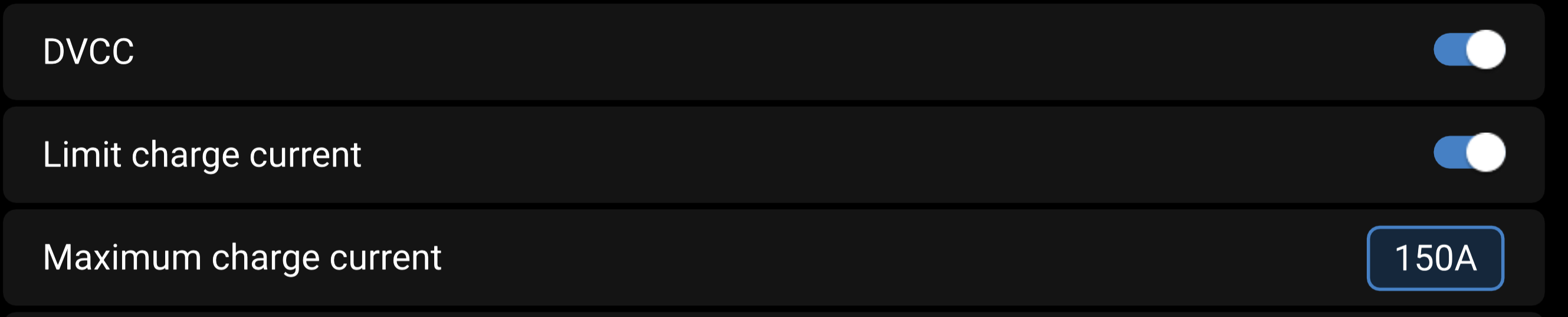

Today I observed the following: As it is battery balancing day today I see big scheduled charge periods during the cheaper timeslots.
As shown by below picture, DESS forceast 11.12 kwH into the battery. However, i have set a max charge current of 150A to the batteries. This means It will pick up only 53V*150A is around 8kWh per hour.
Am I missing something it does DESS not take the max charge current into account when building the forecasts/schedules?
Hi Marcel, as far as I know DESS only works/calculates based on the Dynamic ESS values in VRM! This means you need to match what your system can do (or what you limit it to do) in de settings on VRM.

Hi cotje, makes sort of sense, but is confusing.
