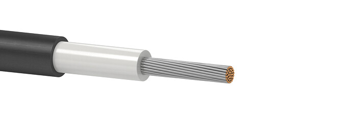

Vertex Marine makes excellent -and appropriate- wire, and they’re up in BC. Try looking for local distributors of Vertex Marine wire - your local marine electronics supply stores would be a good place to check, or just Google of course!
Decent halogen-free tinned copper cable with a seamless twin sheath for PV setups tends to be reel-only.

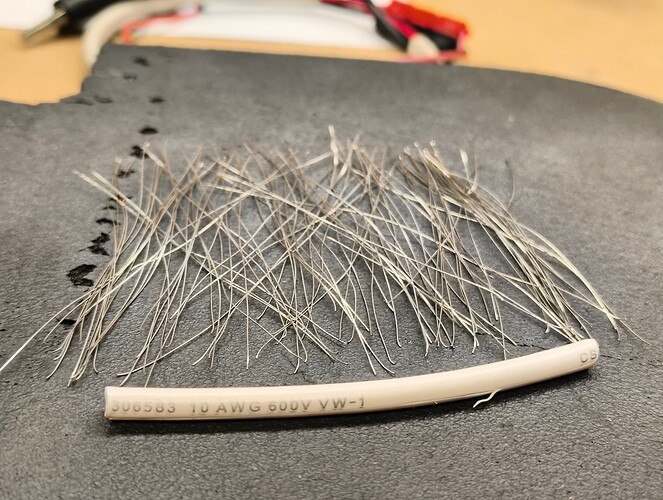

I mean it’s not my business, but an authorized Victron dealer certainly shouldn’t be providing 19-strand wire for an application that calls for ~109-strand wire… I have no desire to call out your dealer here in a public forum, but you might drop a line to salesUSACanada@victronenergy.com just to let them know your dealer needs some additional training!
Editing to add: to be fair, I only count 103 strands in Ancor 10AWG, which would be about the same in Vertex wire… still quite a sight more than 19 though.
