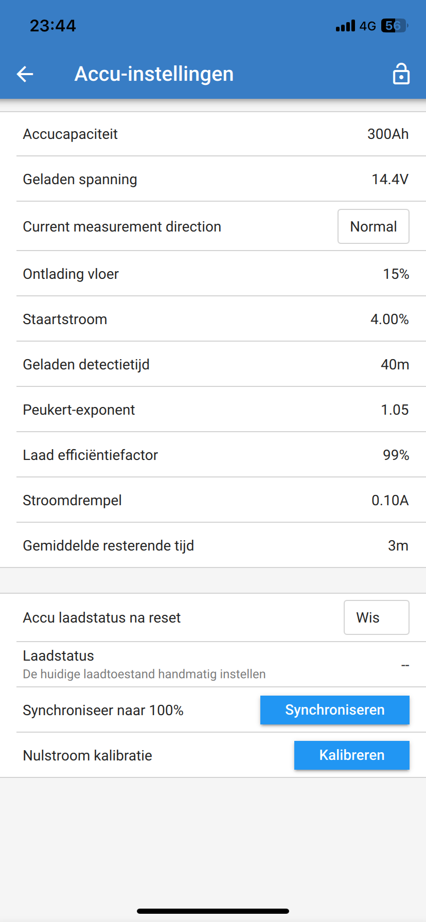

If BMS and shunt are showing incorrect SOC, they need resetting / calibration, I don’t have a Daly BMS so can’t help on this one.
If shunt is victron, there is settings / calibration needed to be set.

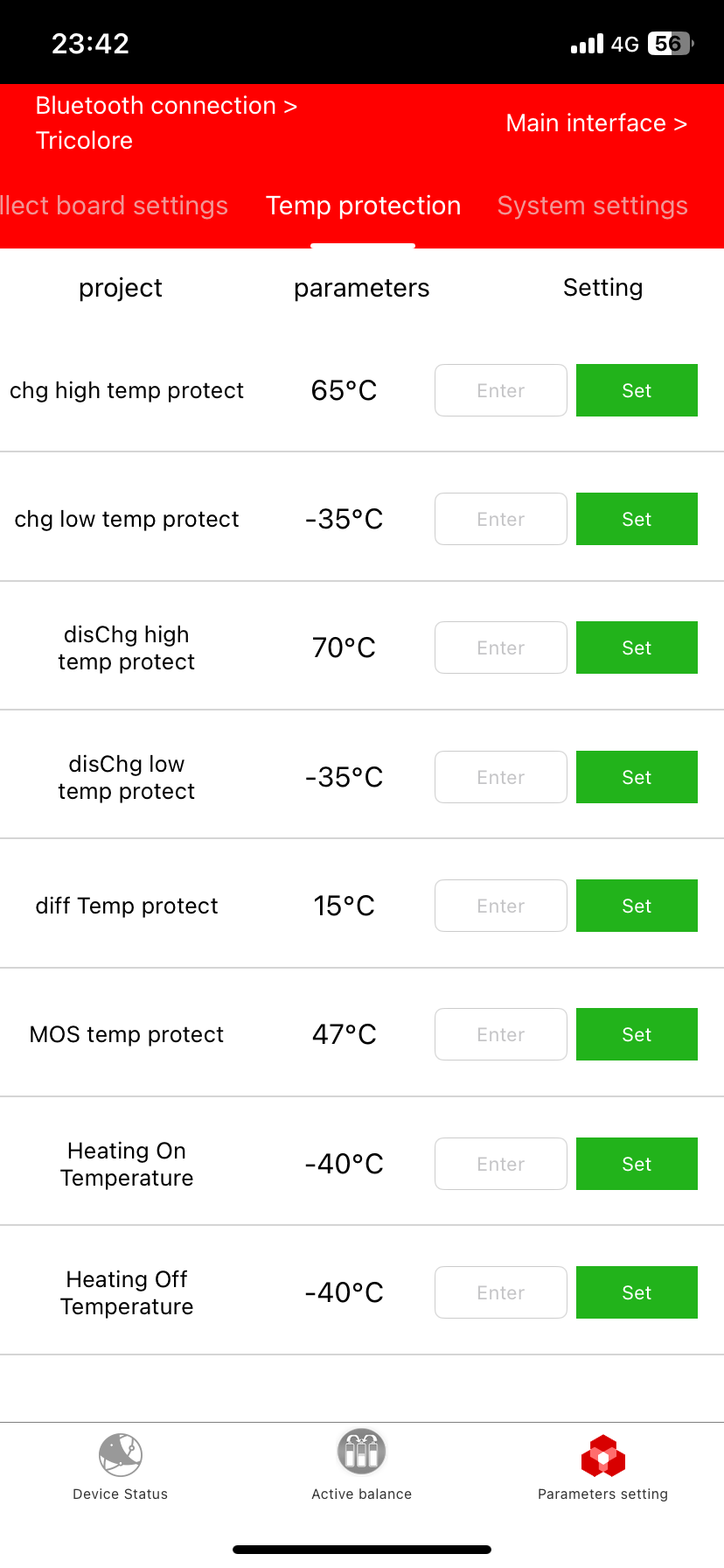

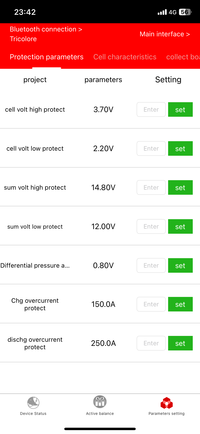

Some of your settings seem to require a look at eg: ovp 3.7v ( bit high? Battery specs unknown), low temp protect -35c ( bit low, battery specs unknown), mos temp protect 47c ( seems low, but Daly is unknown to me)
All settings should be set to known data specs and if they are not known then research.

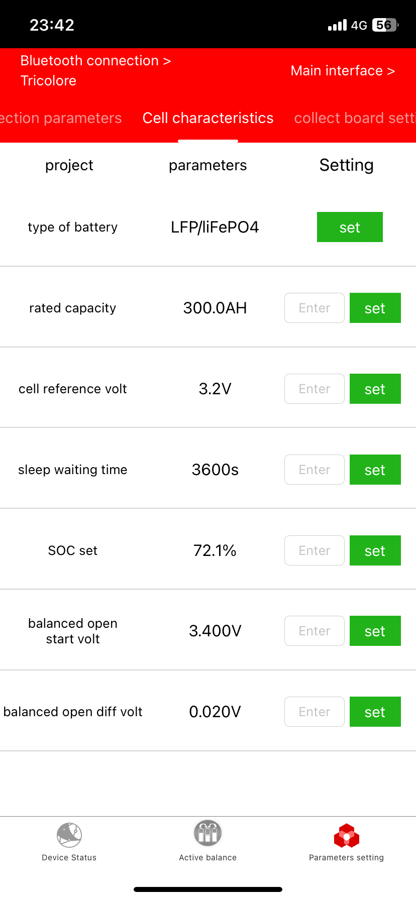

Daly bms are horrible about soc drift. I use a smart shunt for soc and current measurements, and i have an automation that syncs the Daly soc to the smart shunt soc. Without that automation the soc drift gets ridiculous in short order.
I have a smartshunt as well so if i may ask.
How to do the sync
First make sure that the smart shunt is set to restore the current soc and not reset it when the shunt power cycles.
