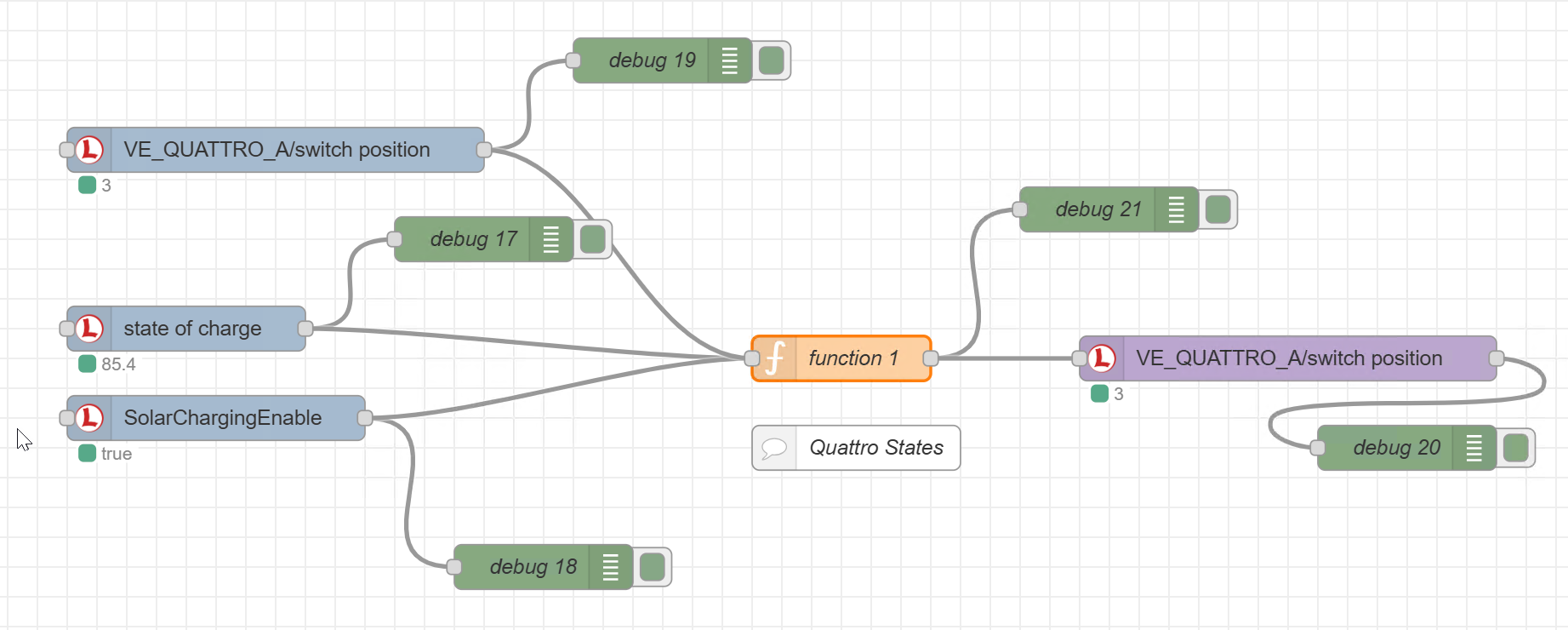

We added some basic Node-RED logic to force the revert to sustain mode/renewable energy preferred after 24 hours.
I also implemented my own strategy in Node Red which makes more sense for a boat.
What did you end up doing in NR?
I have 2 operating modes.
  1. 230V charging preferred:
    In this mode the Quattro is ON and if 230V power from shore or generator is available it will keep the batteries charged. If 230V is not available, solare will charge the batteries. This is the mode when I am on the boat.
  2. Solar preferred:
    This is the mode when I am away. The Quattro is OFF or inverting (whatever you prefer) and the boat is connected to 230V shor power. Since the Quattro is not ON it will not charge the batteries but solar will keep batteries charged. If the SOC drops below 50%, the Quattro will be switched to ON and starts charging the batteries (when there is a longer raining period like in winter time)
context.data = context.data || {};
switch (msg.topic) {
case “SOC”:
context.data.SOC = msg.payload;
msg = null;
break;
case “Enable”:
context.data.Enable = msg.payload;
msg = null;
break;
case “SwitchPosition”:
context.data.Switch = msg.payload;
msg = null;
break;
default:
    msg = null;
    break;
if (context.data.SOC != null && context.data.Enable != null && context.data.Switch != null ) {
var state;
state = context.data.Switch;
if (context.data.Enable === true) {
if (context.data.SOC < 50){
state = 1; //Quattro Charger only
if (context.data.SOC > 90) {
state = 4; // Quattro OFF
//context.data = null;
return { payload: state };
} else return msg;
