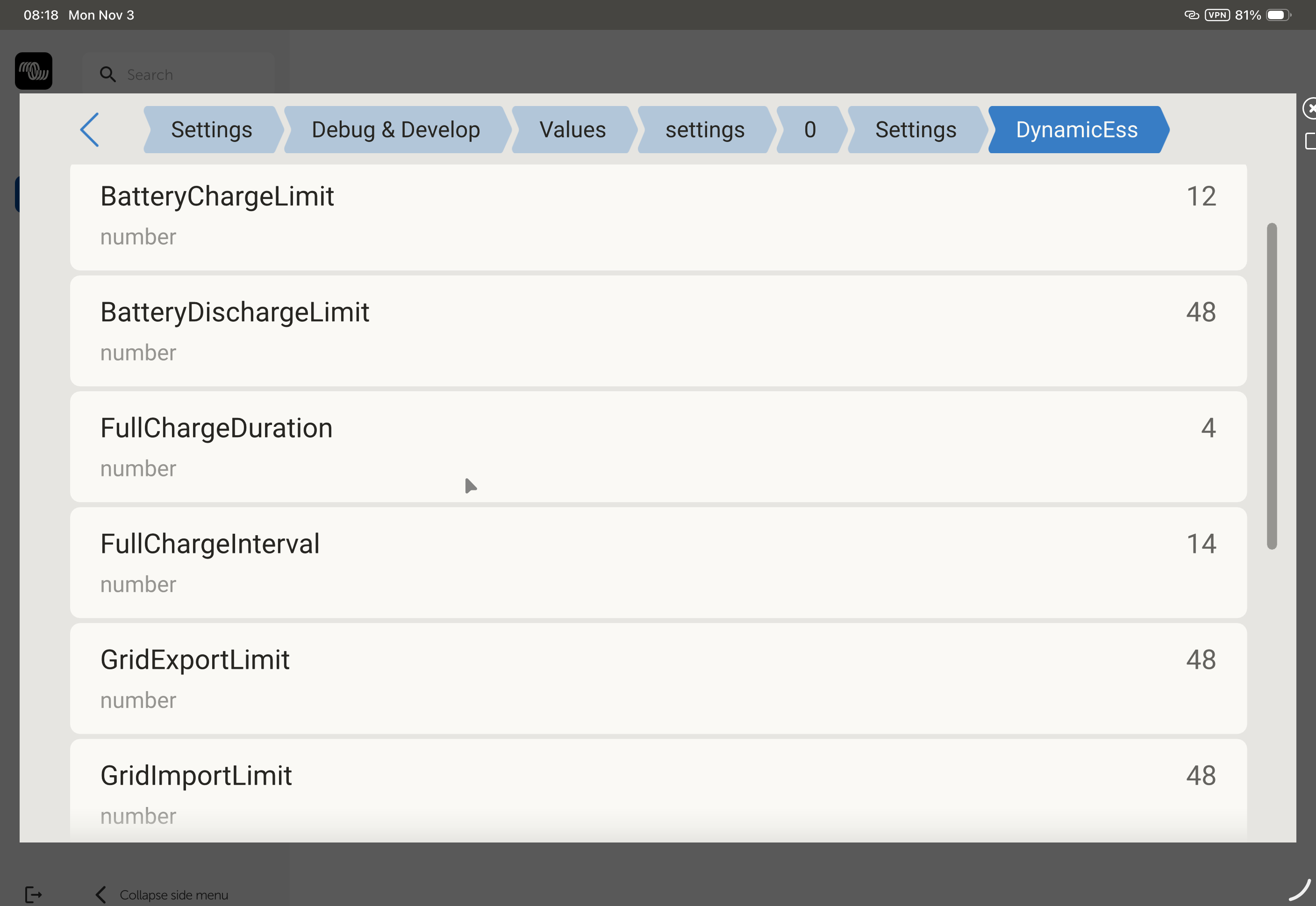

Hi @dfaber
Thanks for the reply. That seems to indeed set FullChargeDuration on Venus, and remains persistent. I haven’t yet tested if it actually changes the balancing duration.
I’m a little confused how this ties back to the various parameters in the API. Please see the few screenshots below.
Venus showing FullChargeDuration of 4 hours, and FullChargeInterval of 14 days.

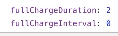

In VRM, the periodFullChargeDuration is still set at 2 hours (which is what I was originally trying to set), and the periodicFullChargeInterval is at 10 days (which is what we set in VRM).
Though VRM is now showing fullChargeDuration at 4 hours (good), but fullChargeInterval at 0 days (don’t know what this means).

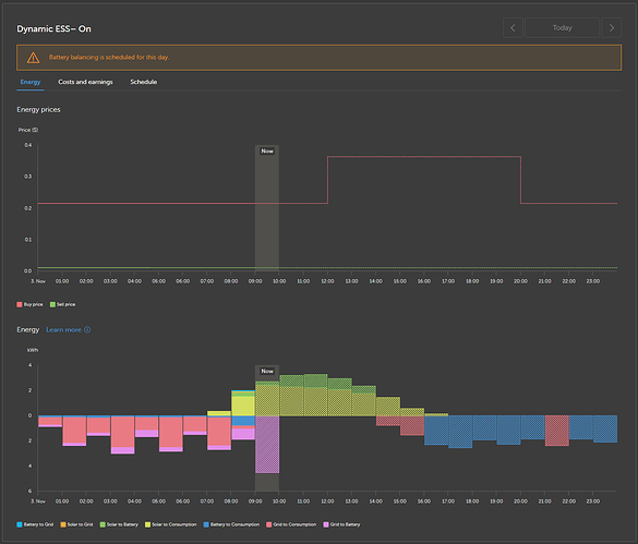

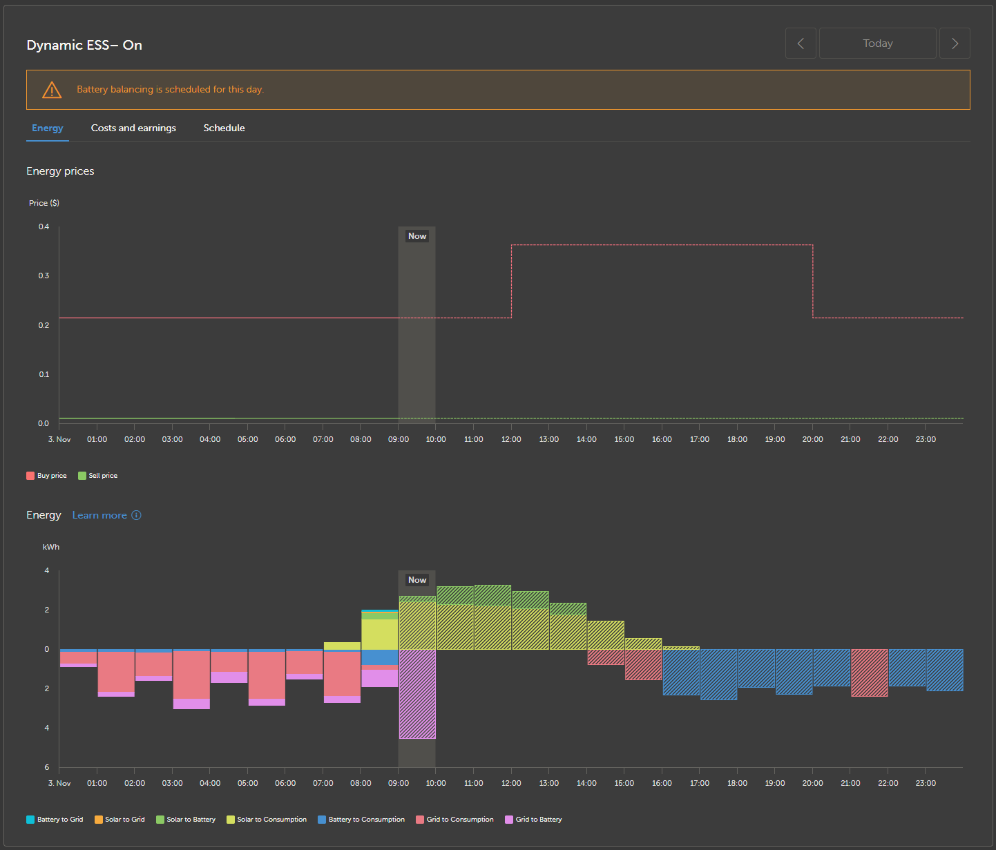

Hi again @dfaber
So I just forced DESS to balance by setting the interval to 1 day in VRM, with “FullChargeDuration” set to 4 hours.
I don’t think the DESS scheduler is taking this parameter into account… I circled the 3 datapoints where the system is scheduled to reach 100% SOC (I would expect 4 hours here).
