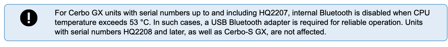

Immediately under that wording, highlighted is this:
Yes, but as I noted in my original post, I can’t believe my Cerbo ever got that hot – it’s in my wheelhouse, not the machine room. But whatever the cause it’s definitely not working, so I’m waiting for the BT dongle to arrive. :frowning:
  • David
Did you update to 3.6x?
If yes that could be the cause.
With the 3.6x the Cerbo has a higher base load and gets warmer.
It’s internal cpu temp not ambient or external temp.
It doesn’t take much with newer code to hit that. Add in extra devices and thats the issue. Been discussed here many many times.
