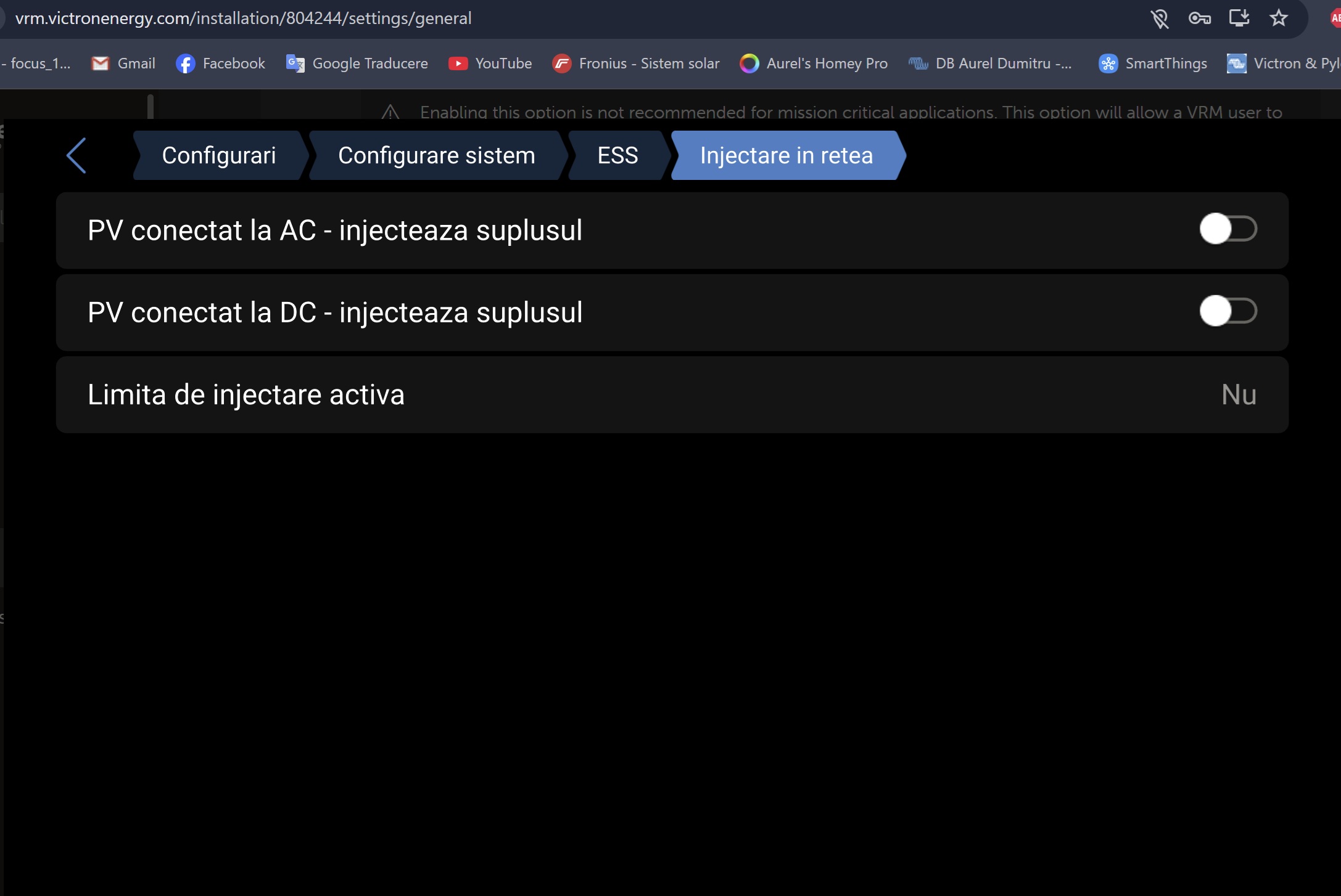

I have just installed a microgrid system, composed of the following devices:
Fronius Primo 5kWh, Victron MP2 5000, CerboGX, ET112 and a Pylontech US5000 battery. My problem is that I cannot stop the injection of excess energy into the grid, although this option is disabled in the ESS menu.
I specifically say that in the Fronius administration panel the control priority first option is set to Modbus, and if I also limit the surplus injection to 0, then the system only produces somewhere around 40-50wh.

In “AC coupled” system it should not be limited. Victron does the export limitation through the ESS assistant, but unfortunately, this time it does not execute and I can’t figure out why…

After more study I found the solution.
In order for the Fronius to be controlled by the GX for injection limitation, Modbus TCP must be activated in both the Fronius datamanager 2.0 and the GX. Thank you all for your attention and your willingness to help. All the best!
