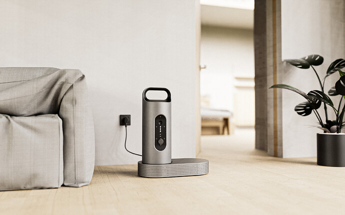

This is a small (800W) bi-directional charger/inverter with 1.5kWh battery that I’m hoping to build at home (i.e. connected to grid).
Can I build this with VIctron components? It’s the bi-directional functionality through a plug that I am finding hard to pin down.
Any advice or direction would be very much appreciated.

Is it not possible for a plug output to be used on an appropriate Victron product? EasySolar for example?
The “mygrid” device that I was interested in a DIY project is being installed in other EU countries (will near similar G98/99 requirements) successfully as a 800W charger/inverter with 1.5kWh ESS despite being plugged into the wall (although is very expensive with a long payback).
