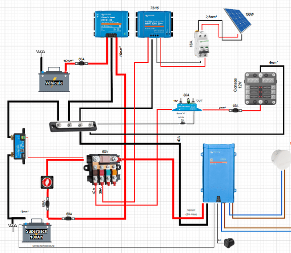

I’m facing an issue with a Victron BatteryProtect showing an E4 overvoltage error on a brand-new installation that I recently completed myself (professionally).
Here is the setup:
• 1 × Victron SuperPack 12.8V 100Ah
• 1 × MPPT solar charger
• 1 × MultiPlus 800VA
• 1 × Orion 12/30 DC-DC charger
• 1 × BatteryProtect
The client has shared the logs/graphs from both the MPPT and the SmartShunt, and both devices report a voltage around 15.6 V at the moment the issue occurred.
I have double-checked the configuration of all charging devices:
• All of them are correctly set to 12 V systems
• All charge voltages match the recommended values for the SuperPack
• The BatteryProtect is also definitely configured for 12 V operation
• The client confirmed that the main cable lugs and connections are properly tightened
I simply cannot understand how such a high voltage spike could occur on this system.
Has anyone seen something similar before?
Do you have any ideas or troubleshooting paths I should explore to determine the cause of this unexpected overvoltage?
