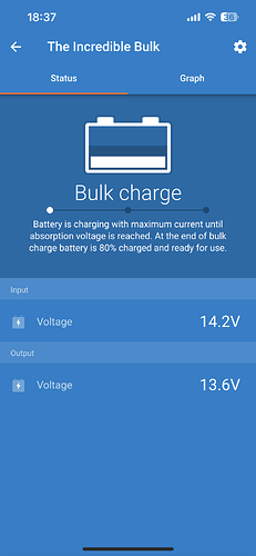

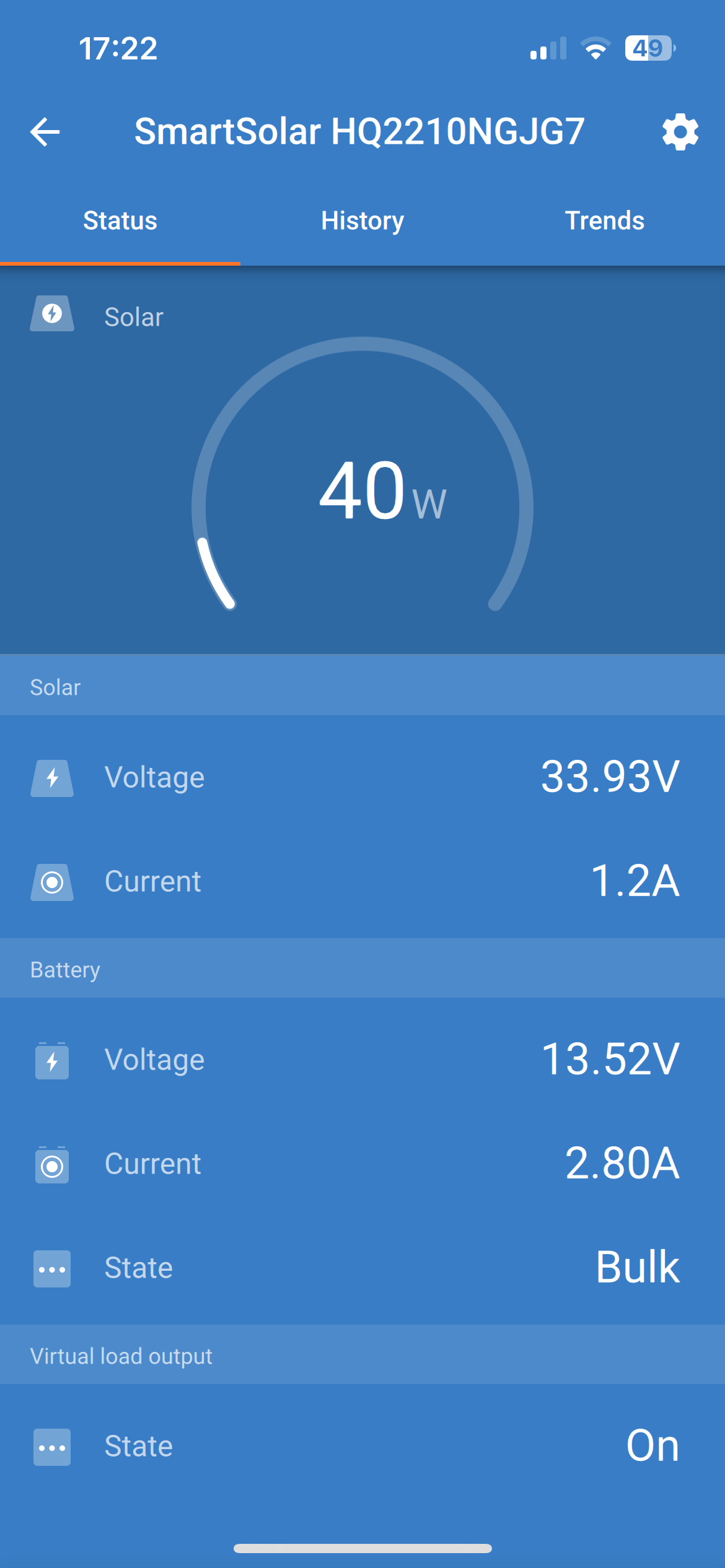

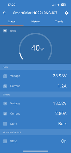

Battery showing %100 but DC/DC and MPPT still in bulk
Hi, I have a lithium battery and MPPT 30/100 and a DC to DC charger the battery is showing 100% but the DC to DC charger and the MPPT are still in bulk. Is there a reason for this? Does it need to get up to the high voltage first and then drop down

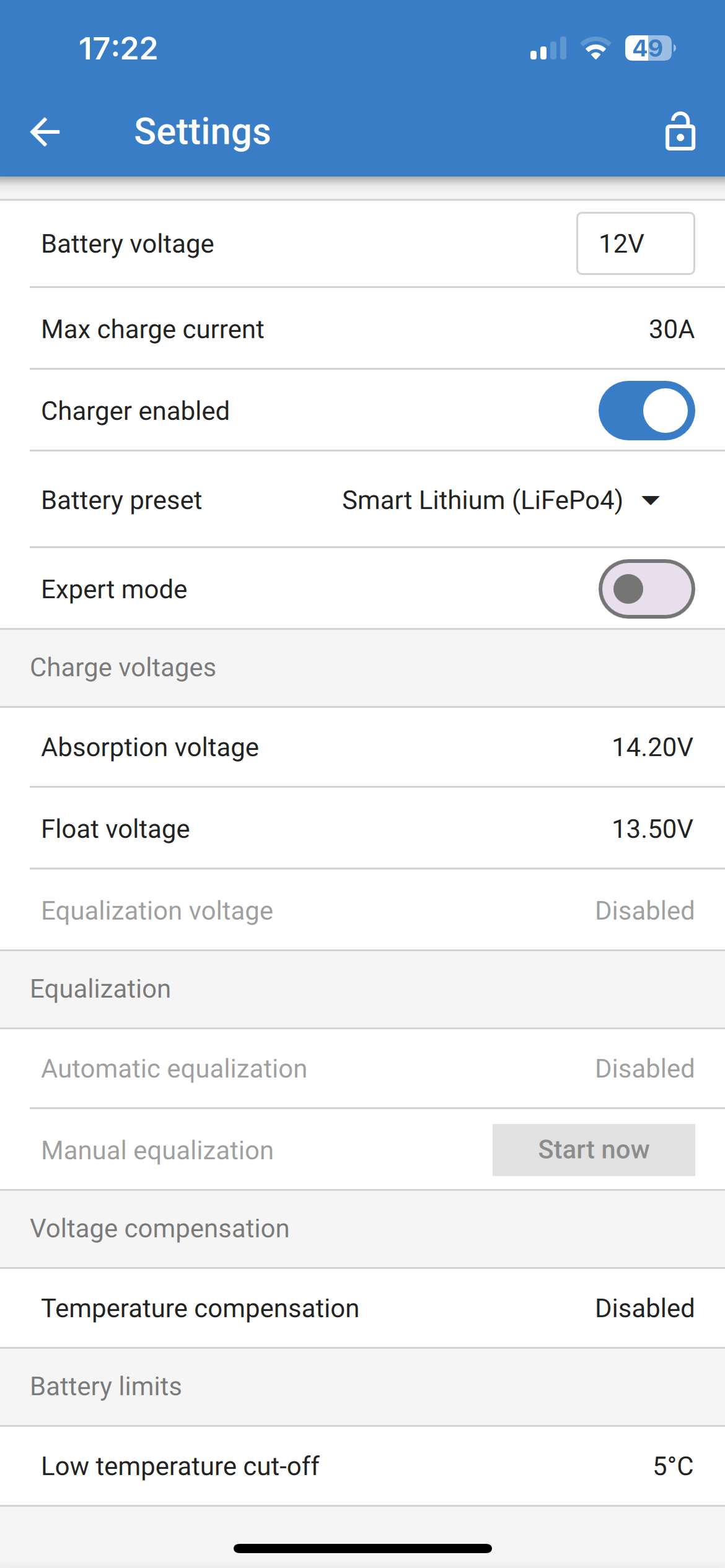

The charging algorithm is based on the voltage not the SOC.
The charger is in bulk until it reaches the configured absorption voltage.
