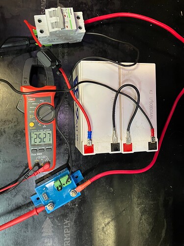

Trying to figure out what im doing wrong. I bought a smart battery protect ran a wire from the battery positive to the in terminal and ran the black wire to the negative battery terminal.
Nothing happens, no lights, no bluetooth signal just nothing.
So i figured it maybe was a bad unit so i ordered another, this one only works with load attached but on my 24v battery its reading between 5 and 9 volts and power cycles endlessly.
Am i missing something? Its the 65amp version if that makes a difference.

Thanks, mines wired pretty much the same. I found a video showing how to reset by jumping the ground and prog but that didnt do anything. If i jump the ground and alarm it works like it should until i remove the jumper and voltage drops and the unit turns off. I submitted a support ticket
What is the black wire? Is it the load or battery negative? This is where the load goes. You dont really need a battery protect for a lithium the BMS will disconnect when it get low. You really need to use M6 lugs as well not much contact with that 10mm.
The black wire was to a positive bus bar, i cut my battery cable to install and since it didnt work i decided to scrape together whatever cables were laying around to test.
Im hoping to use the battery protect to cut power to an ecoflow delta i charge via the solar input giving more important loads longer life.

Thats the closest the battery protect has read to actual. Multimeter shows 26.49v, the charge controller shows 26.46v.
Im starting to think this might not work out
They are a good switch for remote switching. If your solar charger has load terminals you could do some control with that. Or if you get a cerbo and bms and can track the SOC you migh tbe able to use it. My voltages are 0.01 to 0.02 diff.
Mine is way off, im pulling it for the night because I dont trust it with a jumper cable but it looks to be almost a volt lower than actual.
Something seems off. When you remove it, check for continuity and verify if the relay is working it should be OC. It might be welded and used for a capacitive load. I’ve heard of people damaging them; using them for an inverter is not allowed.
Im no expert but this is what youre talking about right?
Yeah thats it its open and working. When you energise it do you get a tone?
Yup, with a value of .002 if that means something
