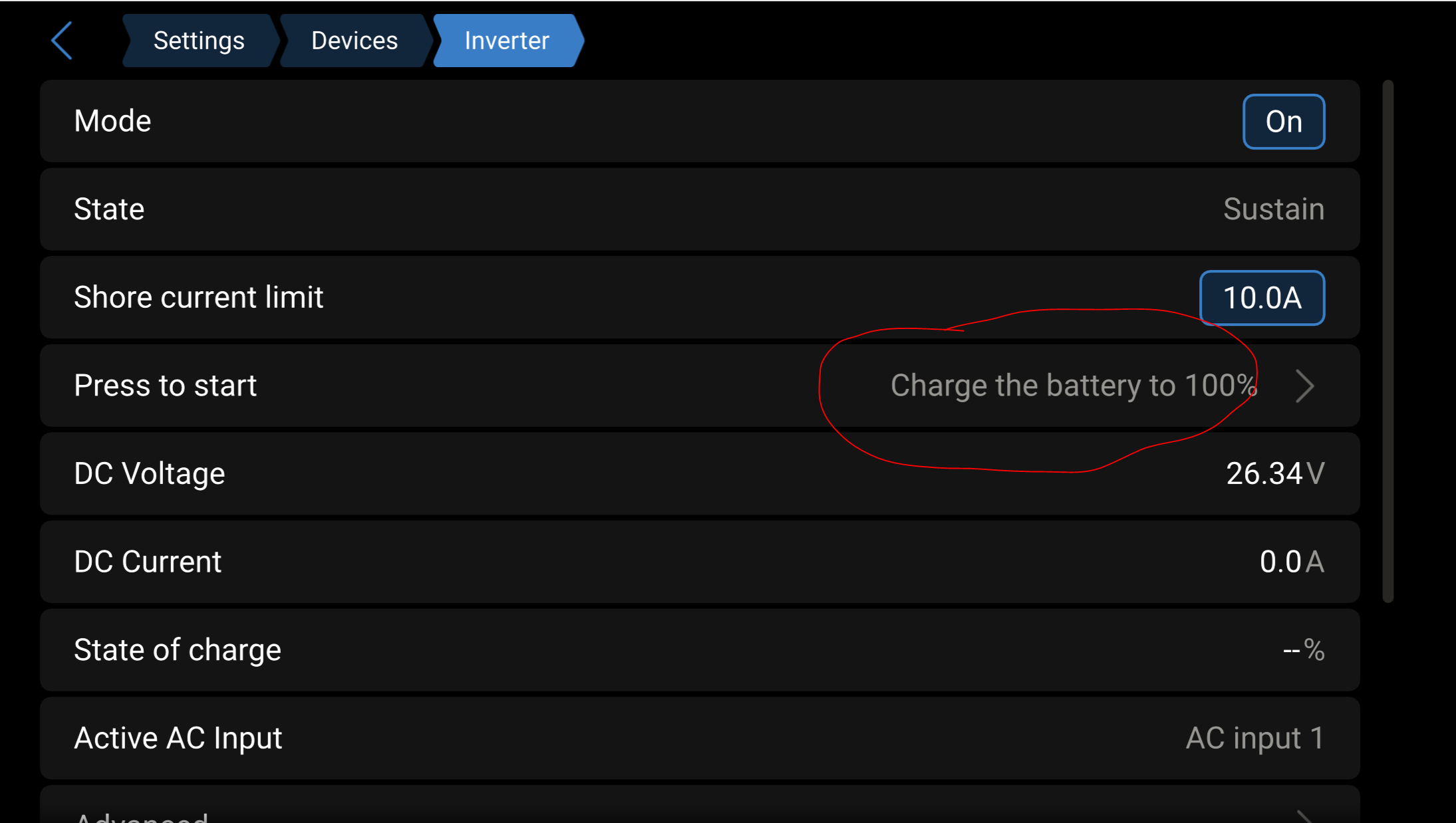

I changed something in VRM (input current limit) to 25A - It is the multiplus that is set to that. I have no idea how to get to the Cerbo settings.
What software are you using in the first picture?
It still thinks the batteries are at 100% when they are at 11.58V

It’s a web browser with the interface to the Cerbo. If it’s on your WiFi network, venus.local might work, or the IP address of the Cerbo, or open the remote console in VRM as shown in post #4.
