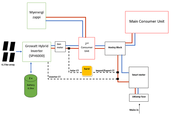

My question is how easy will it be to add these? Attached is a rough layout of my system.
Will this new kit ‘play nicely’ with my current system, in terms of one trying to charge the other etc (which I wouldn’t want).

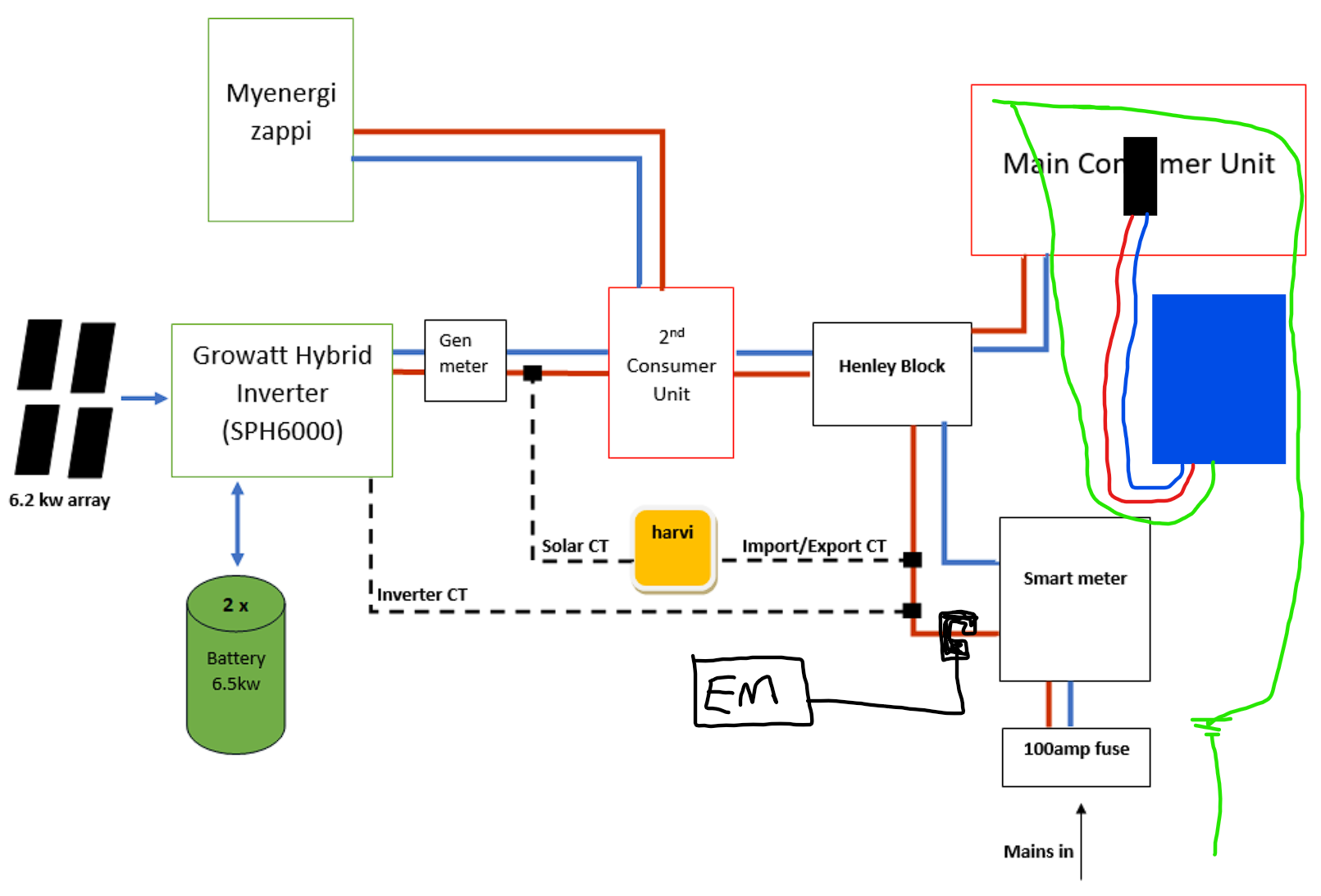

Would somebody be kind enough to take my schematic above and modify it to include the Victron inverter to show me how it should be connected in?
I think what’s confusing me most is the Victron AC connections, let me explain… my Growatt inverter has a single AC connection that is fed from my 2nd consumer unit. This powers the inverter, and supplies power to my house loads. The victron inverter looks to have several AC connections?
Just put in here assuming there is a ground rod. Put an energy meter on the output of the the smart meter. Assuming you can actually do this based on the electrical codes or laws.
