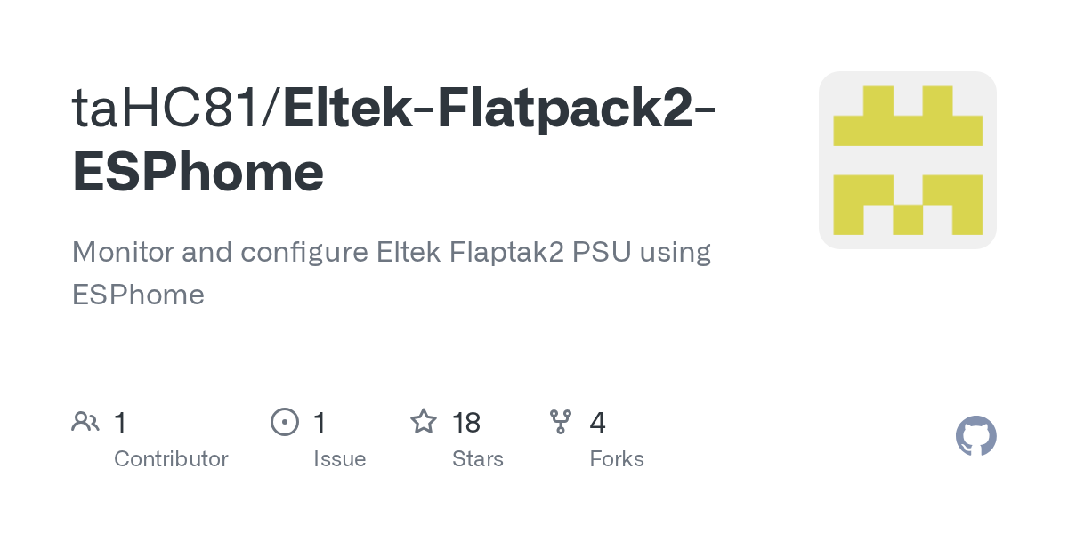

Solution would be changing generator AC via a telco 48V PSU to DC. Common PSUs are Eltec Flatpack2 and Huwei. Voltage and max current can be programmed and even controlled via CAN-bus. Not by VenusOS but EspHome/NodeRed/Home Assistant.

Get a PCB which plugs into the back and provide convenient access to AC in, DC out and CAN-bus. Some boards include a potentiometer to set VDC and MAC current
B) CAN-bus control via NodeRed or Home Assistant
Else use an ESP32 with a EspHome software:
This can be integrated into HomeAssistant or via NodeRed into VenusOS
There are more projects on GitHub to interface with Flatpack’s CAN-bus.
I hope this helps.
