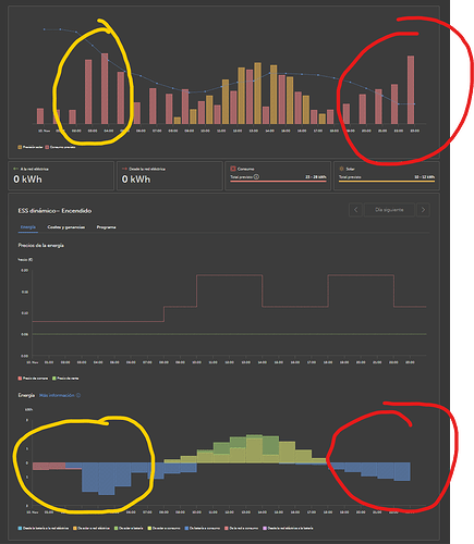

Hello! I have a question, I recently put in place DESS in my Victron and CERBO GX System, with these parameters:
What do you think about the next behaviour that it’s planning for the next monday?
The weekend is all the weekend with low fare , But when we reach monday, I have low price during de night and it’s planning to use battery, we have some planned solar but not enough, and it still plan to use in the night (Yellow color in the image) with not enough kwh for the 18:00 to 22:00 what is the high price always.
And you can even see that it’s planning to use battery when it knows that is not enough battery (Red colour in the image) by the way…
Thanks in advance! And in general, good work for the Victron team!

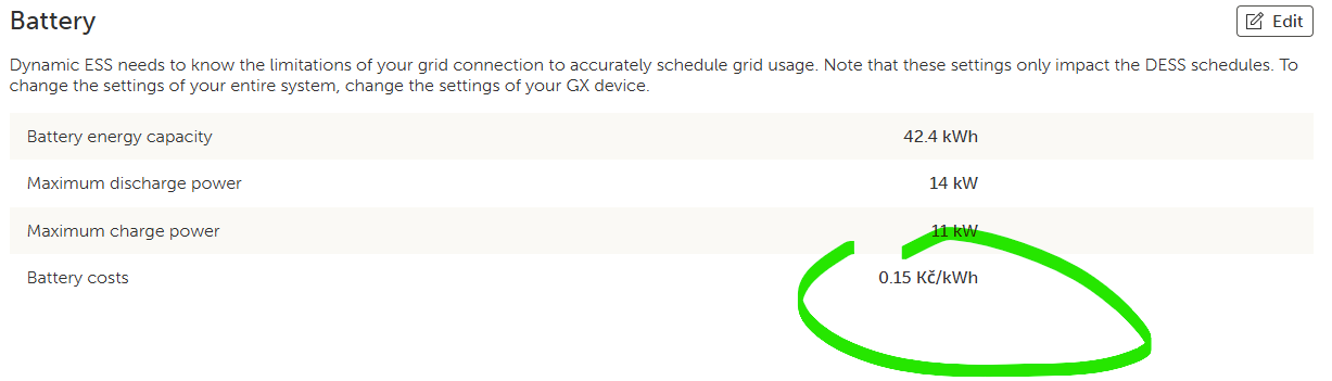

I have the same problem with the battery cycle cost. I can’t enter a value higher than 0.1 CZK — the field won’t accept anything larger. My site currency is set to CZK.
Thanks for looking into this!
Hi, there is possibility to submit price over 0.1CZK. Ther is only red note that the price is high, but you can submit price over 0.1CZK withou problem. See my setting.
Thanks for the clarification — I missed that! :+1:
And note @Victron : there is probably just one limit number for notification message - 0.1. This can be fine value for EUR or USD, but not for CZK, neither for Iranian Rijal :slight_smile:
Value for warning should be calculated based on currency.
